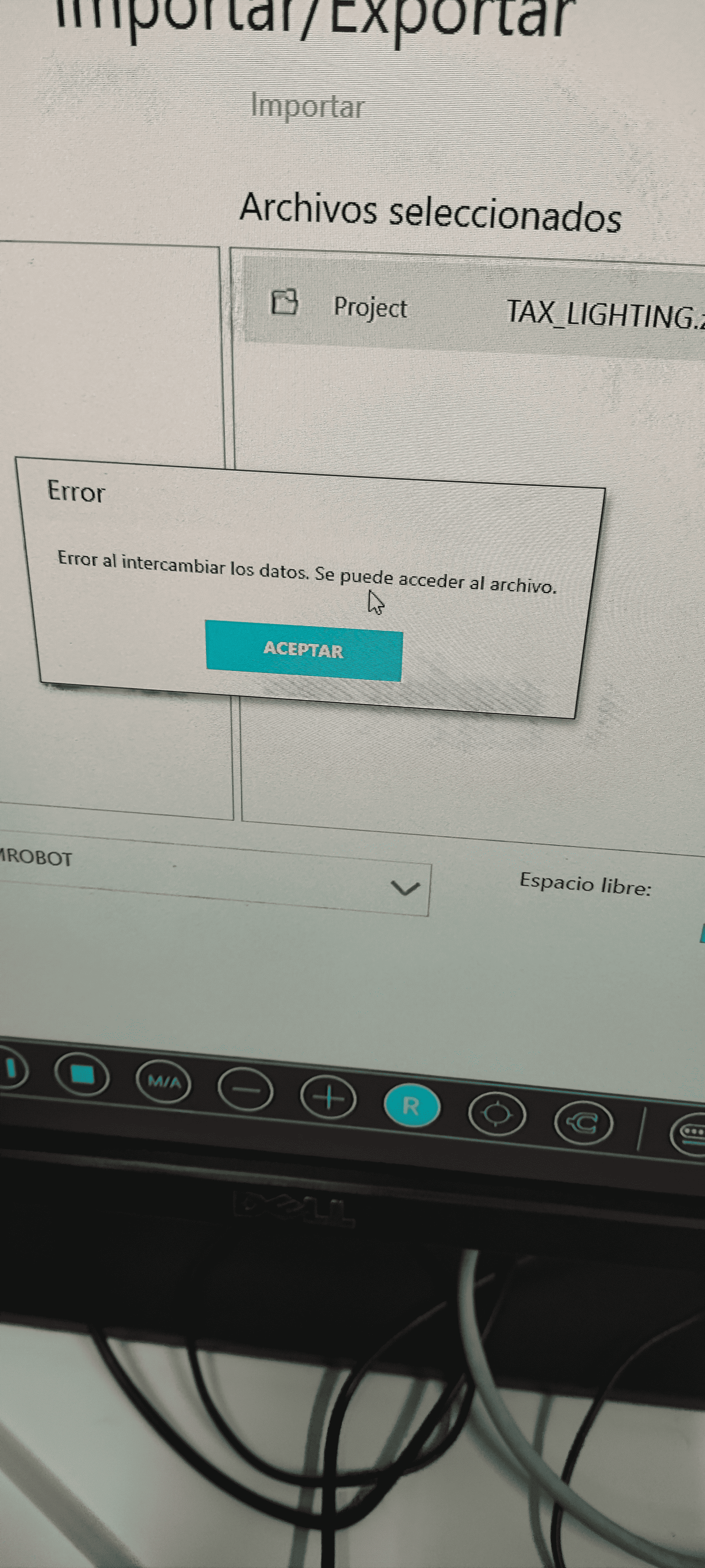

Good morning, I am new to RoboDK, and making a small program with a Robot TM, when I make the function to generate program to be able to import it in the software of TM, ‘TM Flow’, when making this importation, it generates me an error and it does not load it to me inside the software of the Robot.
Do you know what is the reason for this import failure? Since it only happens if I import the program generated within the RoboDK, if I import any other program from another TM Flow, it works correctly.
I attach an image, it is in Spanish, but the translation is this:
"Error when exchanging the data. file could be accessed"
Thank you

We have tried the file that you have sent us, but it still does not work, I attach an image of the error that appears, and also of the SW and HW version of the Cobot.

The current error message says:
[Error][Com.]Data exchange failed. File may be accessed.
It is not easy to point in the right direction. Do you have any other information to help troubleshoot this error? Omron/TM used RoboDK extensively to program TM robots.

When I introduce the program made inside the RoboDK, when I pass it to the removable unit, previously I must have made some export from the Cobot Omron so that inside this removable unit it creates a folder with an alphanumeric code that represents that it is the ID of the Cobot.
Once this is done, if the program that I generate in RoboDk I put it inside this folder, example:
\TM_Export\Robot_ID\project name.
I have tried to introduce it inside this folder, and it has already opened it.
Thanks for your assistance.
