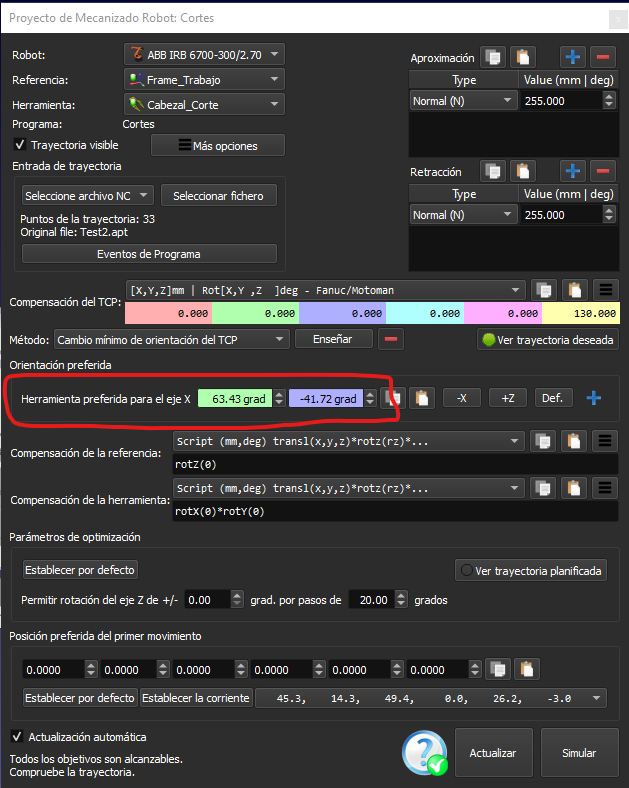

Change Preferred Tool Orientation via API
Hello again!
¿Is there any way to change these parameters via API?
Thanks

Thank you for the response.
'OrientXaxis2_X': 0.5820855000871991, 'OrientXaxis2_Y': -0.6790997501017323, 'OrientXaxis2_Z': 1.4472135954999579, 'OrientXaxis_X': 0.5820855000871991, 'OrientXaxis_Y': -0.6790997501017323, 'OrientXaxis_Z': 0.4472135954999579,
How I can convert those units to degrees? Not radians
Good question... the XYZ values describe a vector.
What you see in RoboDK are polar coordinates to represent these unit vectors.
