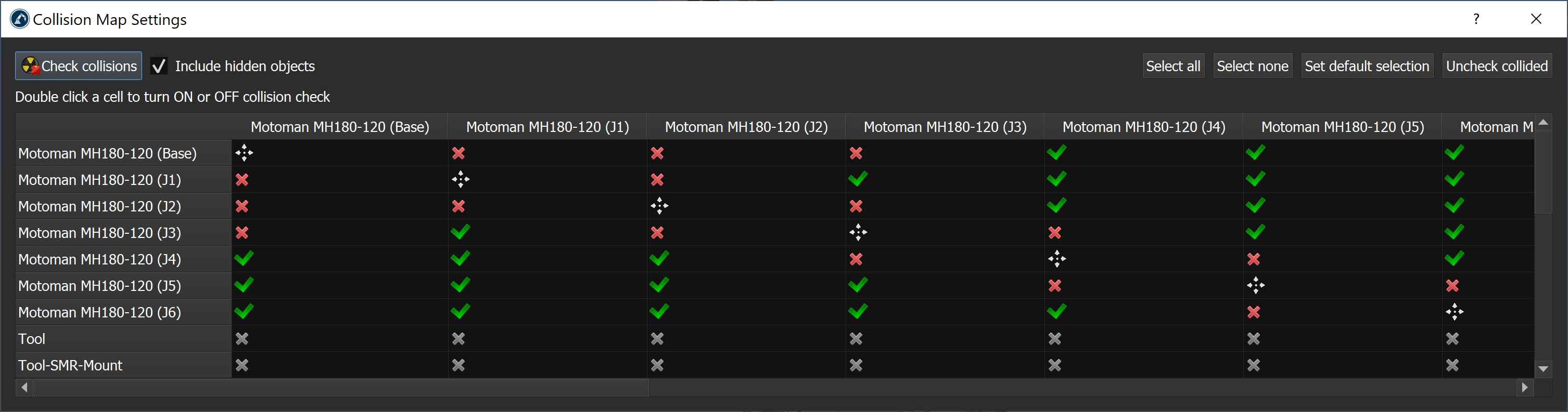

Is it possible to export the collision map table of collision pairs? I have a template station that has a standard uncalibrated robot in it. When I replace the robot with a calibrated robot, the collision pairs within the collision map table reset to default. My goal is to export the collision map table pairs from our template and use those values to set the collision active pairs with the python API, rather than manually comparing and updating the tables.
Thank you!
Brent

The Plugin Command you shared shows how to interact with the collision-free motion planner which is not the same thing.
It is currently not possible to extract the list of active pairs of objects that are checked for collisions.
If you have a professional license you can contact us via Help-Request support and we can try to prioritize this as a new feature request.
