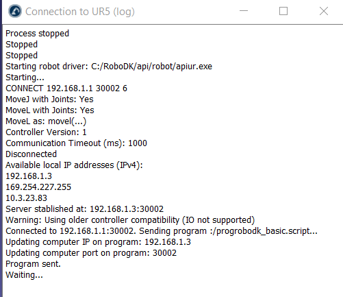

#38
Hi Albert.
I have tried multiple ports, always with the same result. In each case there are no errors or warnings displayed in the PolyScope log (sample output attached).
 - RBE
