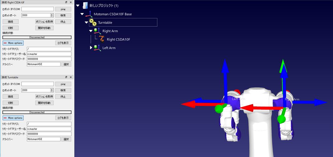

Hello RoboDK support,
I am writing this post on behalf of a university student who has just started RoboDK.
He is facing an issue of  connecting with  MOTOMAN-SDA20D/20F.
  • RB downloaded from :MOTOMAN-SDA10F DualArm
  • RB in real use:MOTOMAN-SDA20D/20F
  • Controller:FS100
Could someone help us to solve the problem?
I attached the error log and the simulation screen.

He had a trouble in connection with real Motoman robot although he proceed based on the document.
The possible reason for it is that he uses similar but different model as MOTOMAN-SDA20D/20F is not on the Library.
I hope someone take a look for it.

Did you load the ALL.PRM file as explained in the documentation?
More information here:
https://robodk.com/doc/en/Robots-Motoman...omanPulses
This may not have worked properly because this is a 7-axis robot but you can review the pulses/degree ratio in the robot parameters menu.
This line does not look normal:
Using -2000 external axes
If you can send us the ALL.PRM file we can better investigate.
