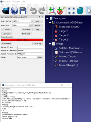

I tried to use RoboDK's connect robot feature (online programing) with Yaskawa Motoman FS100 controller.
After connect with HSE, it's ok to get correct position of robot but the robot didn't act by using "Move joints" button.
Base on the log, it was "Connection problems" and do you know how to fix it?

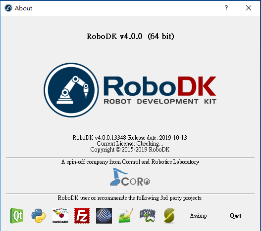

RoboDK version: v4.0.0 (64bit) on Windows 10
Driver: MotomanHSE
Robot: Motoman FS100 controller + SIA20D
Best regards.
PenceCMKo

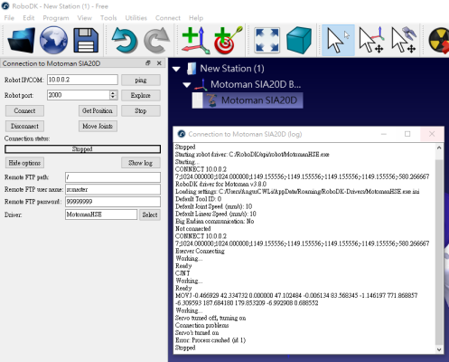

Hi Albert,
By using the latest version of RoboDK (v4.0.0.13379), the robot connection feature works well on our 7-axis robot with HSE.

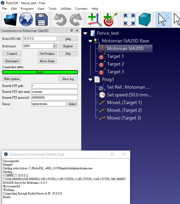

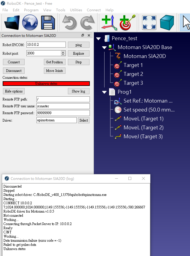

Hi Albert,
I tried to replace MotoCom32.dll only, the license issue still happened.
Then I replaced another 3 more files, Motolk.dll, Motolkr.dll and vrp32.dll. Then the license issue was fixed.
Using the apimotoman driver, the RoboDK can connect with robot but no response with "Get position" .
Does it need update for the "RoboDK driver for motoman" for 7-axis robot?
Best regards.
Pence
