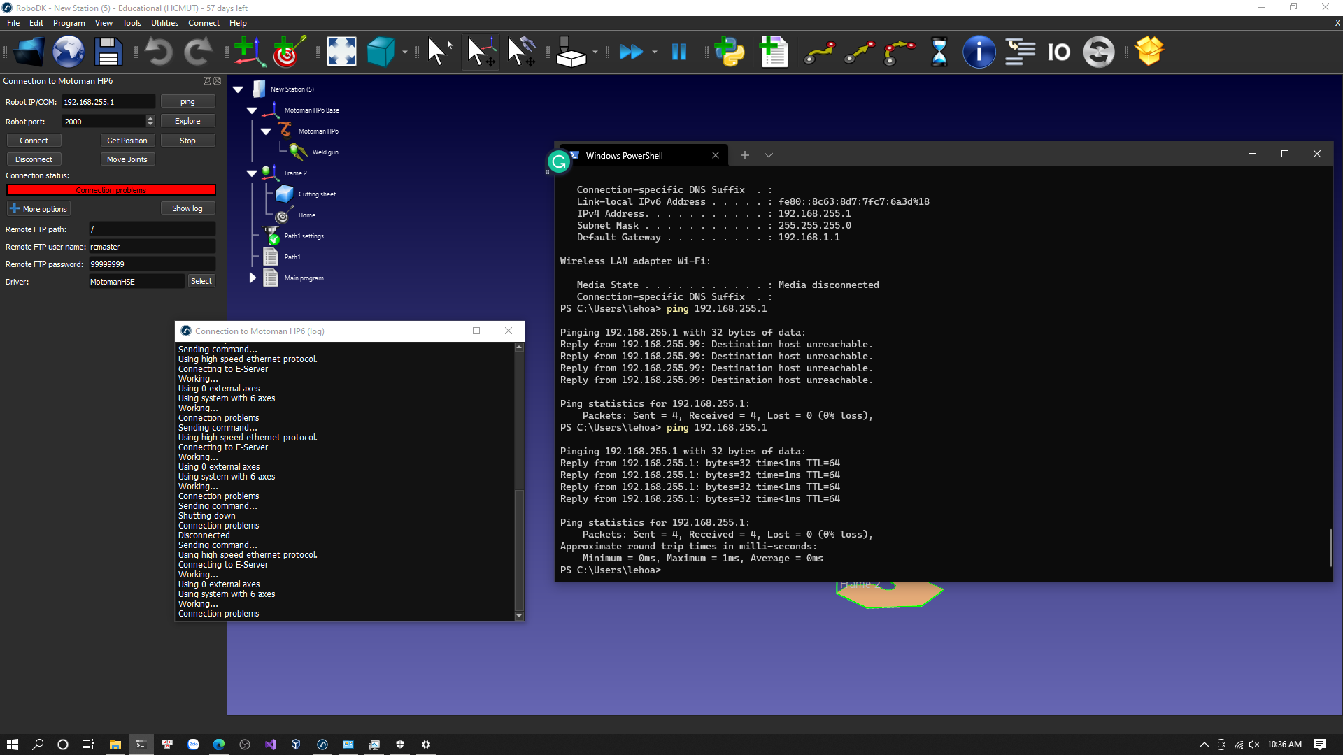

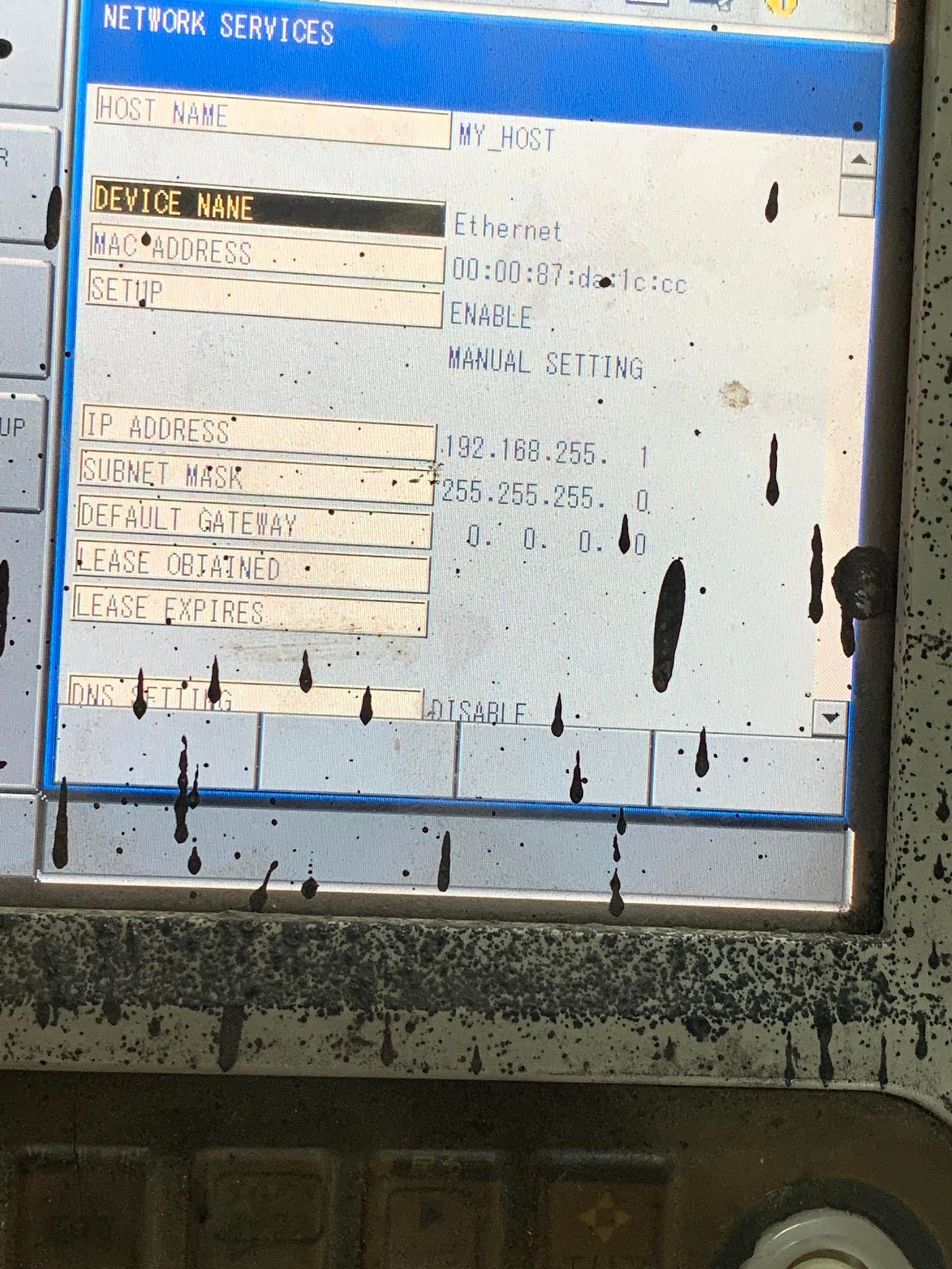

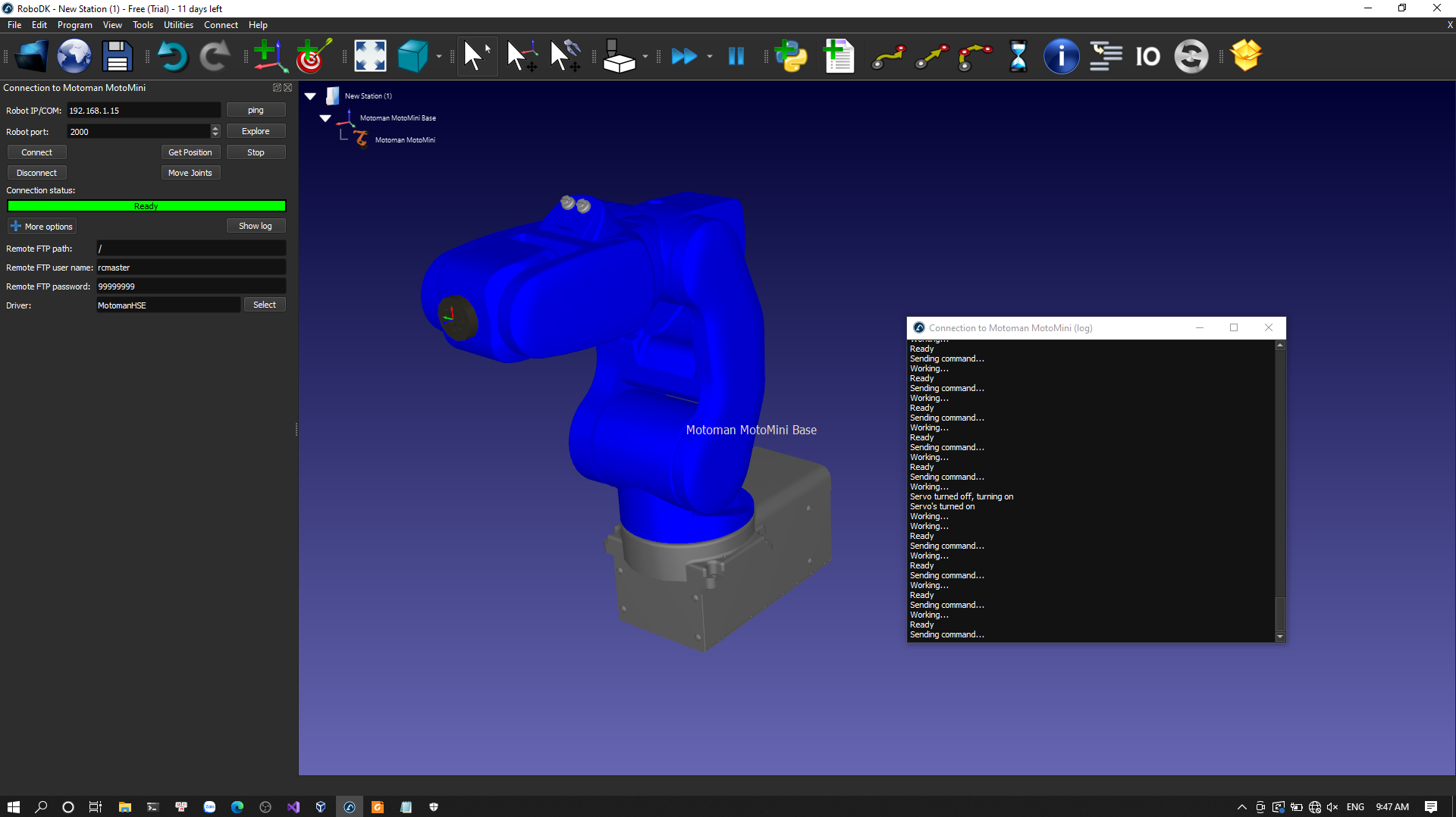

I'm having some problems connecting RoboDK to NX100 Motoman controller.  I have followed all the steps in here https://robodk.com/doc/en/Robot-Drivers....oubleshoot, https://robodk.com/doc/en/Robots-Motoman.html and made a ping test. The communication between my computer and the controller was successfully done. However, I still couldn't connect and didn't figure out a way to fix it while I succeeded in connecting RoboDK with DX100 and YRC1000 controllers. Can you guys suggest to me some solutions for these problems?

Yes I have tried it with the teach pendant in "Remote Control" mode.
And I also have tried the buttons "Get Position", "Move Joints" and "Stop"... and in the log file I am getting always "connection problems"
