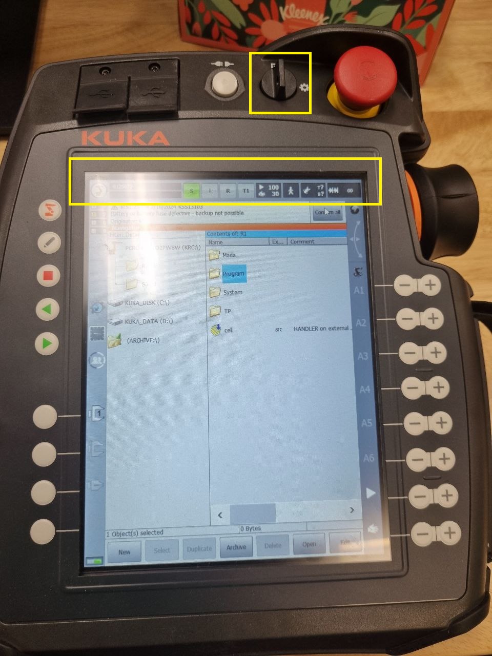

I followed every instruction in the post you shared and by changing the port number to 7002 I could get the connection. If I may ask another question, when I try to move joints or run on the robot, I receive a "working" message (attached images). I think some settings on SmartPad are not right. Do you mind if I ask your opinion?

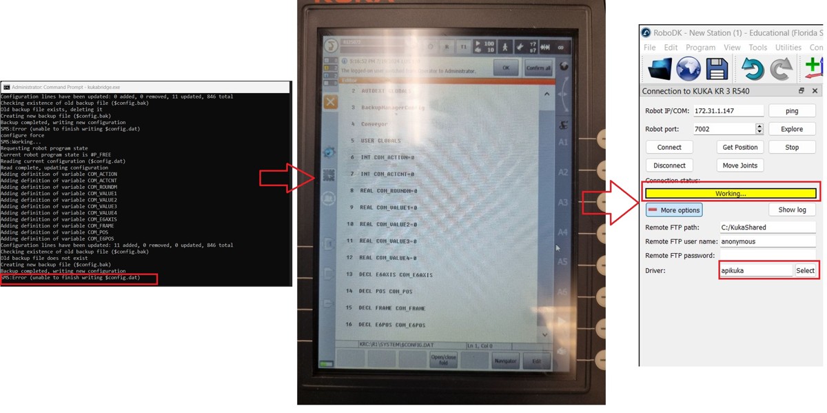

I followed your instructions, but the automatic configuration didn't work as it couldn't replace $config.dat. I manually added the lines to the $config file and ran the RoboDKsync570.src file. However, I still get a "working" message when I press "move joints."
When I move TCS manually, the robot moves as expected in the software, but I cannot run the robot from RoboDK. Do you think there might still be a configuration issue?
Thank you in advance for your time. ( I added some images for better clarification)
Make sure the KRL program RoboDKsync570.src is running and not just selected.
Also I noticed in your screenshot that you are still using apikuka instead of kukabridge.
