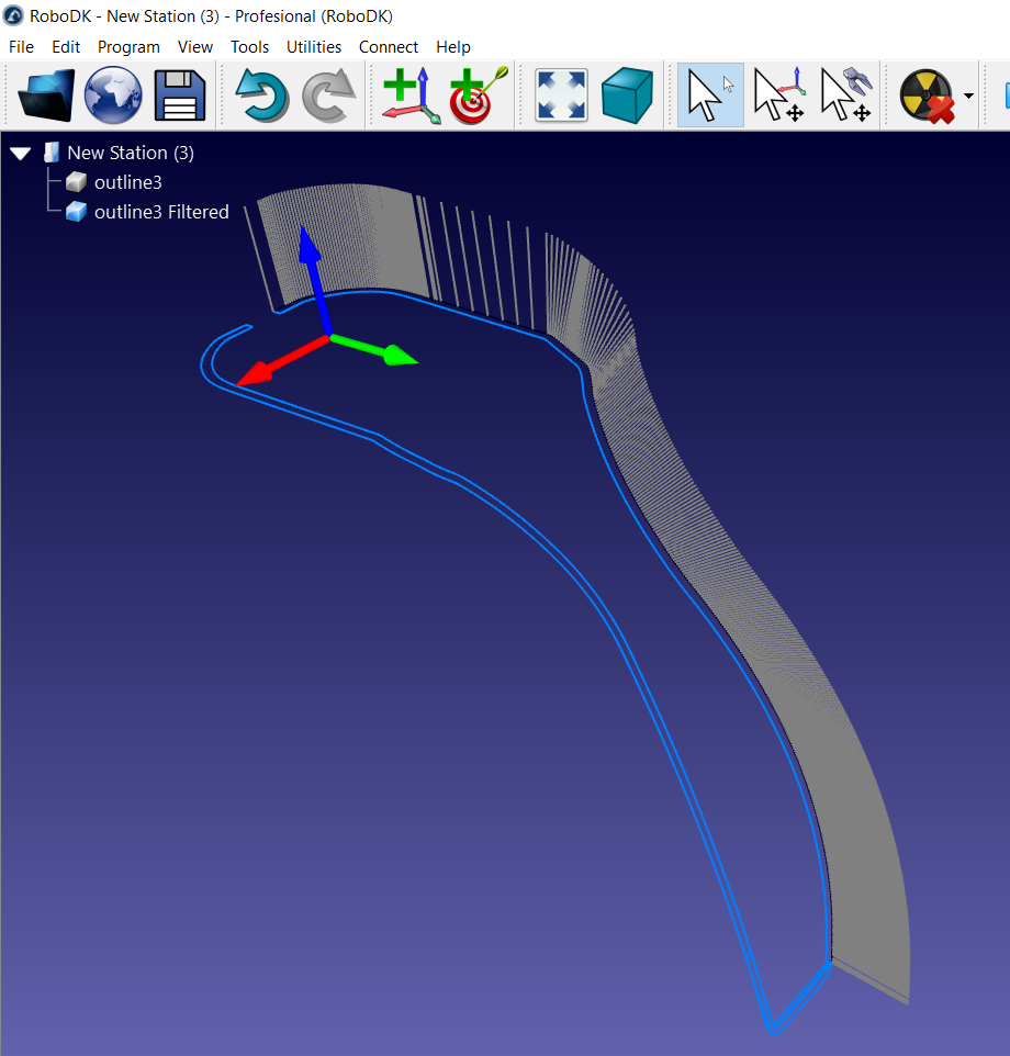

I recommend you to follow these steps:
  1. Go to Tools-Options-CAD
  2. Set Linear/Angular/Curve accuracy as 0.5 mm/deg (the 3 values)
  3. Load the STEP file
  4. Select Tools-Run Script and run Curve Filter Average Normals
  5. Select the object you just loaded (you may have to select it twice)
  6. Leave the filter size to 10 (default) and select OK, you can increase this to make it smoother.
You should see the result attached.
It looks like you used SolidWorks to generate the STEP file.
Have you considered using the RoboDK plugin for SolidWorks? Importing smooth curves will work without having to follow these steps.
