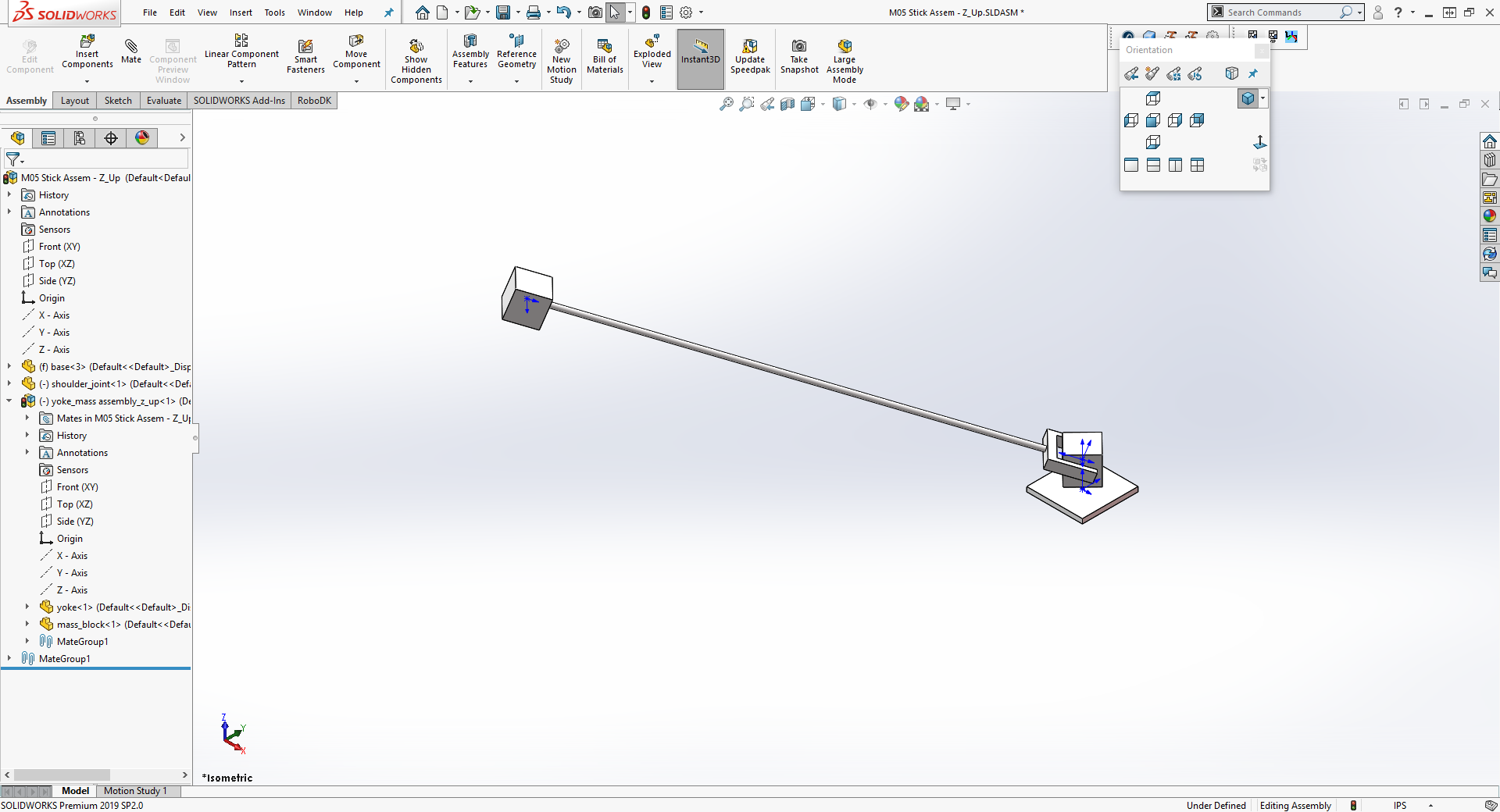

I am having trouble importing a customized robot model into RoboDK. I have converted my SolidWorks assembly into both .step and .stl files for each individual link.
Importing the .step and .stl links into RoboDK does not maintain the robot assembly and each link is imported into the same spot - center of base frame.
I would like to have it so that the links are imported into RoboDK as they are assembled in the original SolidWorks Assembly. I have attached screenshots of what the SolidWorks assembly looks like and what the RoboDK import looks like.

Hi Albert,
Thank you for your response. I tried exporting the assembly but it makes it so that I cannot configure the separate parts as joints in RoboDK - it is imported as one solid piece. I need to configure rotation about the z (shoulder joint) and x axes.
I have attached the SolidWorks model below
