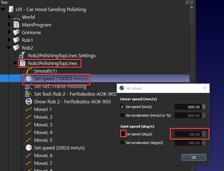

To modify the speed of the first PTP motion, you need to "Right-click" the generated program -> "Show instruction" -> Find the first "SetSpeed" (it should be before the first MoveJ) -> "Right-click" -> "Edit" -> check "set joint speed" and enter a value.

I will push for us to add an option to set the first PTP speed.
In the meantime, I think you can simply add a set seed as the first command of your Main to set the "Joint speed".
"Right-click" -> "Add instruction" -> "Set Speed" -> "Right-click" - > "Edit"
As soon as you have one of those set properly, you can simply "copy and paste" it to another program.

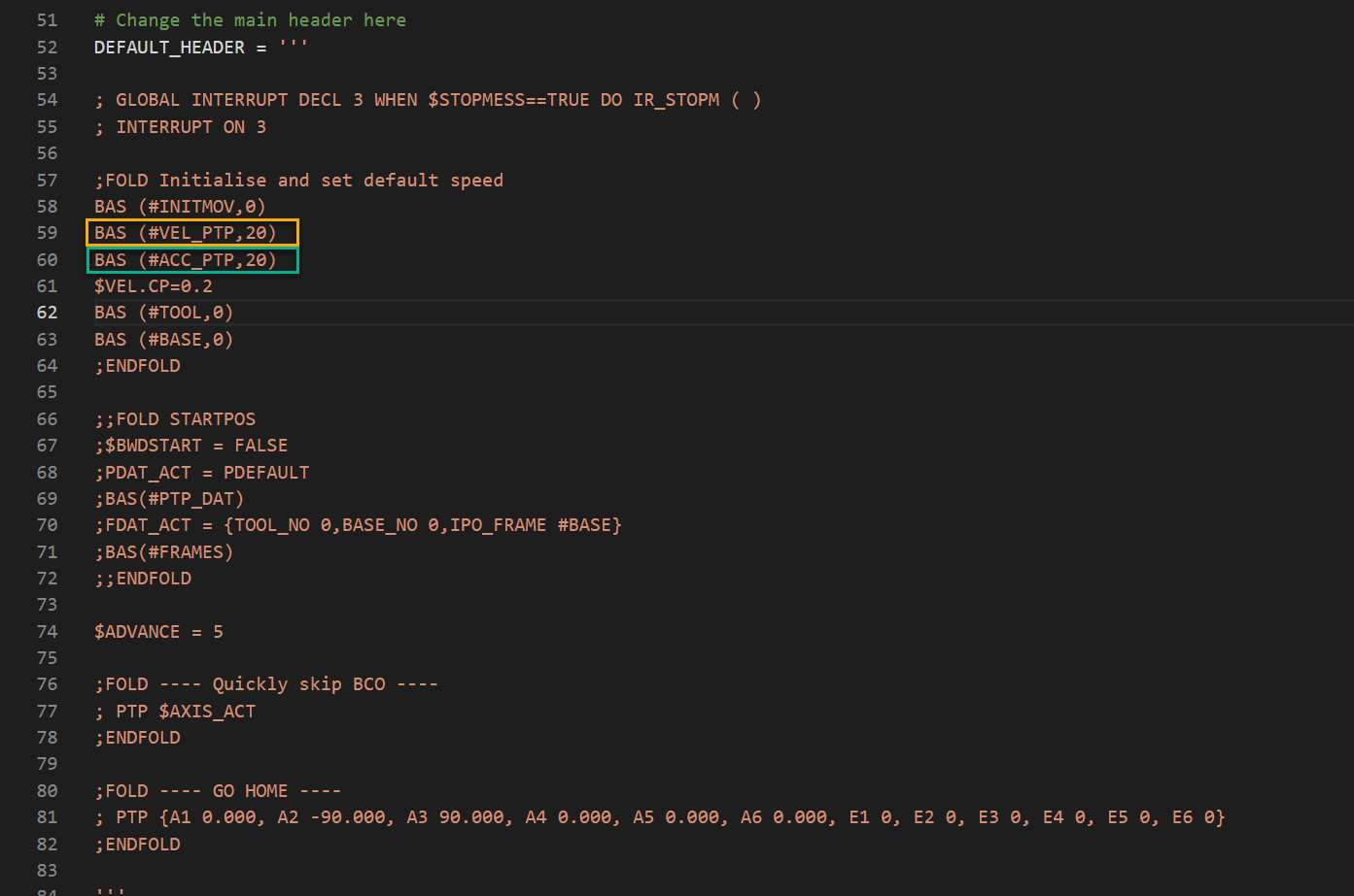

I now have a solution for you.
The PTP speed is actually hardcoded in the post-processor.
We modified the post-processor to expose the porting controlling this.
You will therefore be able to decide the PTP speed and acceleration by modifying these two lines of code in the post-processor.

I added the new post-processor.
You can place it here: C:/RoboDK/Posts

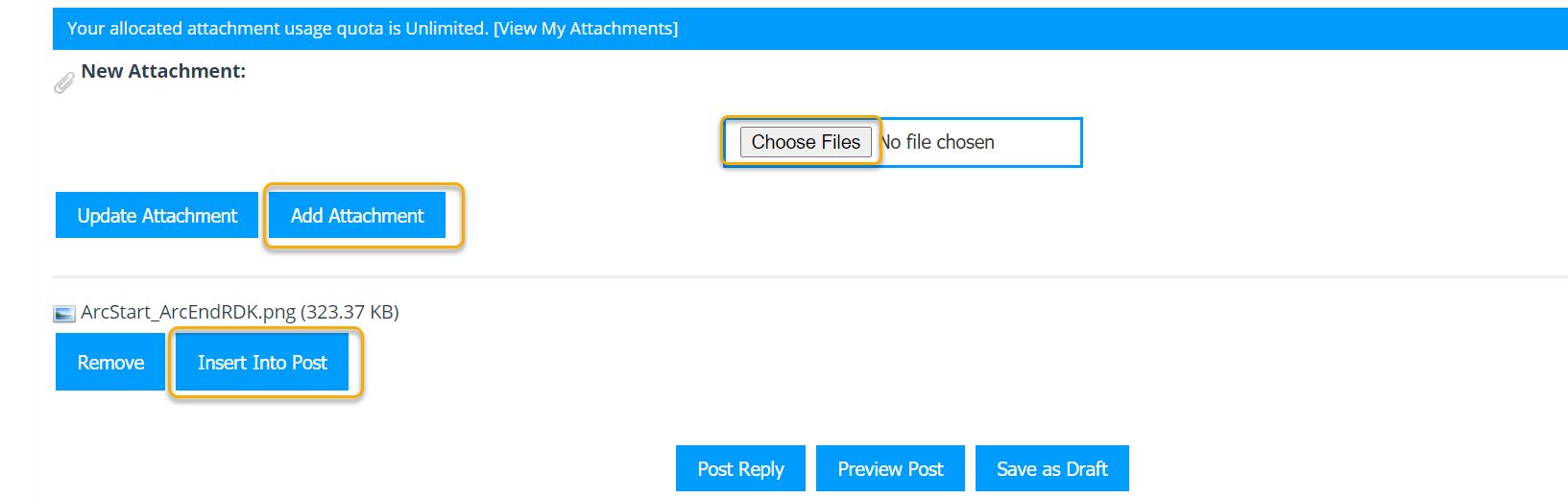

For the image, follow these steps.
1- Choose files
2- Add attachment
3- click where you want to image
4- Insert into post
