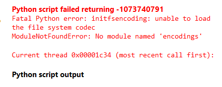

I'm trying to configure my robot by retrieving the real pulses per degree for the MH50 running on a DX100 controller.
I followed this guide: https://robodk.com/doc/en/Robots-Motoman...ation.html
However, I encountered the following error (please see the attached screenshot), when dragging the ALL.PRM file into RoboDK:
Fatal Python error: initfsencoding: unable to load the file system codec
ModuleNotFoundError: No module named 'encodings'
What could be causing this issue?

Please use the latest RoboDK version and select 'Python-Embedded' at Tools - Options - Python - Python interpreter.
Alternatively, if you could share your ALL.PRM file and the exact robot model, we could try to import it and share the updated robot with you.
I am already using Python-Embedded.

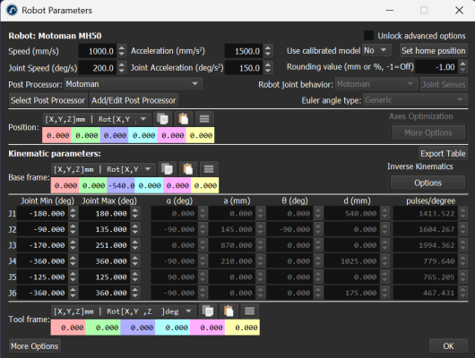

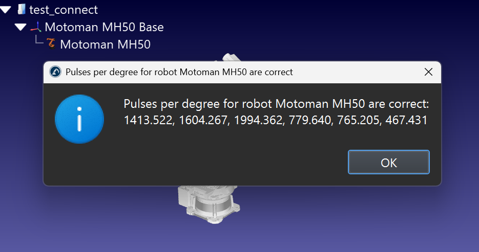

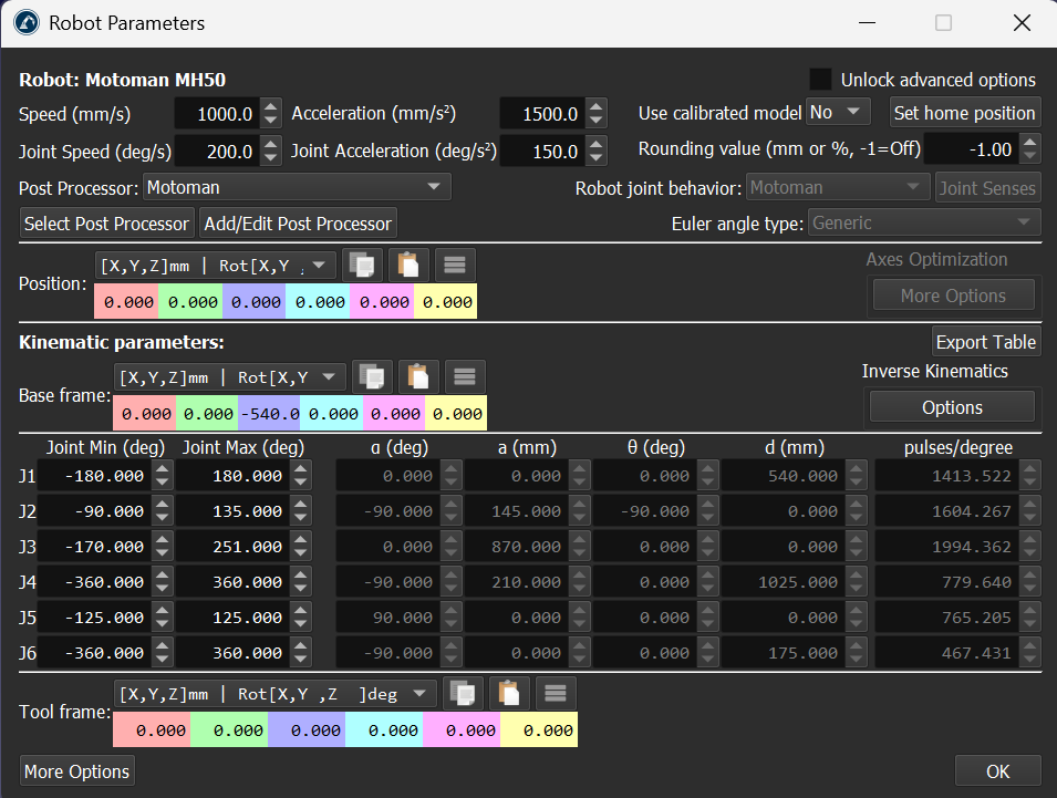

I successfully downloaded the ALL.PRM files you shared:
They all contain the same pulse to degree ratios as the standard MH50 robot from the RoboDK library:
https://robodk.com/robot/Yaskawa-Motoman/MH50
