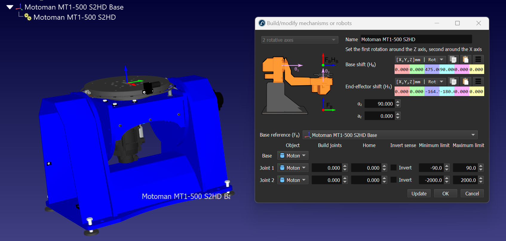

It's necessary to use a '2 rotative axis' kinematic template for such kind of 2-axis positioner, instead of a nested '1 rotative axis' :
Here is a station example with the robot and 2-axis positioner:
https://robodk.com/example/Machining-and...ith-ABB-02
You can find more information about the creation of the mechanisms in RoboDK below the link:
https://robodk.com/doc/en/General-Create...ModelRobot
