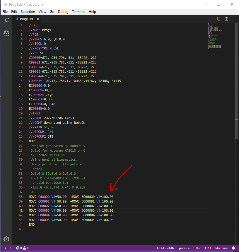

    I have a Motoman ma2010 robot along with a B1L-1500-2500 Positioner. I have synchronized them and I want to change the speed of the positioner. How can I change it?
I have tried adding instructions in the program and also changed the parameters, but only the robot is affected not the external axis.
I have added the screenshot where you can see the external axis remains 100.

I've added a new hook to the post processor for motoman so you can modify the speed of the rail, in order to use this new version, copy the attached files to C:\RoboDK\Posts and overwrite their corresponding versions from your version of robodk. This post also relies on changes to the robodk api in a fairly recent version so I would suggest you update robodk first.
You can change the speed by adding a program call with the special keyword of "speedEx" to set the external axis's speed from 0 to 100% for the next movements. This will change the speed generated for the subsequent moves.
See the attached image for an example usage of the program call.

Hi Jeremy and Phillip,
Thank you!
The program call works for changing the speed of the positioner.
