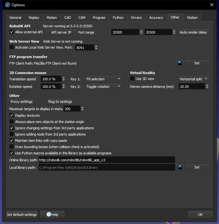

I am trying to load the SprayOn macro offered from you, guys, and I get the error:
"Failed to run Python script. Set appropiate Python paths in: Tools -> Options -> Others".
I have also attached a print screen of the window in Tools.
Can someone be kind and explain to me what's wrong with what I'm doing?

Ok, I went ahead and posted without thinking before.
I found a tab name Python and corrected the paths there and it worked.
** Word of advice: If you change the default path of the program uppon installing, correct also the Python path if you want to use macros.

Hi Jeremy,
thanks for replying so quickly, I only recently downloaded robodk and this is the path file to my python is in my C drive as well as my robodk installation file
Below i included the the tool>options window open and ive tried setting eveything to default and the same error keeps happening
