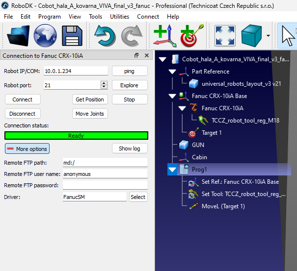

I am trying to connect the cobot Fanuc Crx-10iA to RoboDK. I have setted up all the IP adresses but still not able to connect.
The only succesful connection was with port 21, but that does not work for the get position / move joints / send program to robot etc.
I am not able to connect to PORT 2000.
Could you help me to connect to the robot?

[Image: PvJWVsT4]
To connect to the Fanuc robot using the driver you should follow the steps in this document:
https://robodk.com/doc/en/Robots-Fanuc.html#DriverFanuc
Port 21 is used for FTP. I would recommend you to use port 2000 or higher.

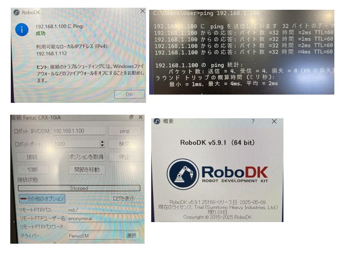

Our customer has a connection issue with the same robot and driver.
Please check the attached sheet explaining the problem and the log.
Thank you in advance for your support.

Dear RoboDK support,
Thank you for the investigation.
Current communication status is as follows;
(1) Cmd Ping: OK
(2) RoboDK Ping: OK
(3) Although pressing the connect button, no connection is established.

Dear Raphael,
The customer attempted to reconnect after installing the socket messaging option, but it failed.
Could you please review the attached error message and let me know if you notice any relevant information?
