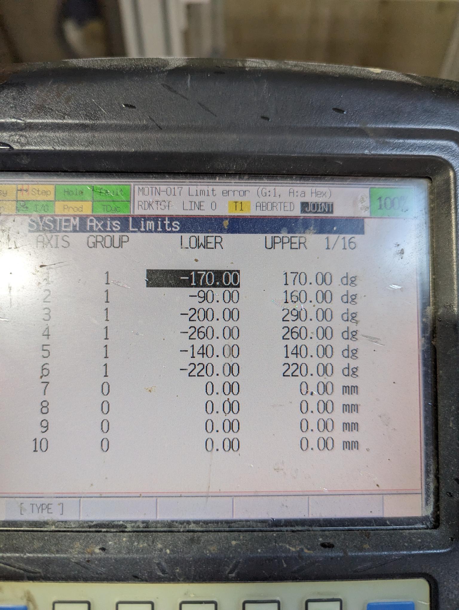

My company recently got a trial to RoboDK and we've run into some issues with running the TP files on our actual robot. We are currently attempting to use RoboDK for toolpath programming. We have the booth and robot positions set as accurately as we're comfortable with. Currently, I am attempting to generate a simple program that consists of 3-4 joint movements. The simulation seems to run fine in RoboDK but when I transfer the compiled TP program to the robot and attempt to run the program I run into a strange axis error (MOTN-017 Limit Error (G:1, A:e Hex). This usually happens when an axis is near it's limit but I've never seen the error code with a letter instead of a number before. I've also attached a copy of the station if anyone would like to take a look and play around with it themselves.
I've verified and slightly adjusted the actual axis limits on the robot versus the simulation but I am still getting the same error after compiling and loading/running the TP program onto my controller.

Were you referring to manually jogging the physical robot to it's J2/J3 limits and then sharing the limit table? I might have misunderstood what you were referring to exactly.
I've jogged the J3 axis to it's limits (I was unable to do this for the J2 axis due to physical booth constraints). I was unable to see any changes in the Axis Limits menu on my Teach Pendant. I've attached images of the joint limits when J3 is at it's minimum and maximum.

Is there a way to get more accurate axis limits on Fanuc robots? When I jog the robot the limits did not change regardless of how I moved the joints. It seems like they're almost a hard-coded value despite the linkage between J2 and J3. The settings you provided don't seem to be accurate to how the actual robot behaves (to no fault of your own, I don't think I provided the correct information). Do you have any suggestions? Thanks.
The robot joint limits shown in the Fanuc system parameters are constant, however, the real limits change. To know the exact limits you should physically jog the robot to the limits to obtain the 4 points required to build the chart.
