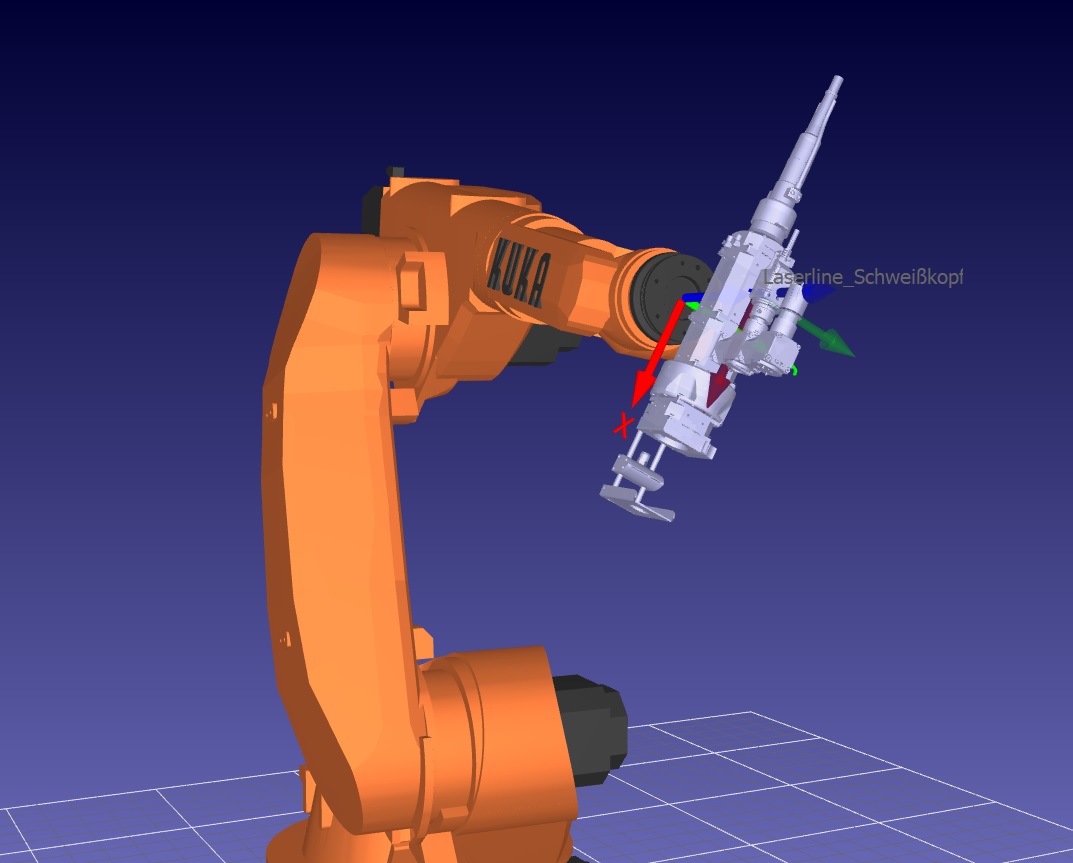

Hello Jeremy and thanks for taking the time... ;)
I attached a screenshot of the virtual situation.
This is the actual home position of our KR30 at the moment. As you can see the flange is rotated a bit  (about 18 degrees).
In the real world there is no such rotation of the tool (laser welding head), because the mount has been rotated in such a way (by 3rd party before delivery) that the laser head points straight to the ground.
My Question is: How can I determine the exact amount of degrees that the flange is rotated in relation to the base of the robot, so that I can adapt the rotation of the Geometry (welding head) to fit our real world situation.
Of course I could take a protractor and measure the offset angle by hand but I would prefer to know the exact numerical value.

Your ~18 deg on the home position, you mean on the real robot? Because I looked in our library and there is no rotation of the flange.
For the simulation phase, I generally position the tool using the flange bolt pattern. That gives you a good enough estimation in most cases.
Then you do a TCP definition https://robodk.com/doc/en/General.html#CalibrateTCP
https://www.youtube.com/playlist?list=PL...LBNEmBE57E
It will position the TCP at the real place so that your generated programs are accurately positioned.
