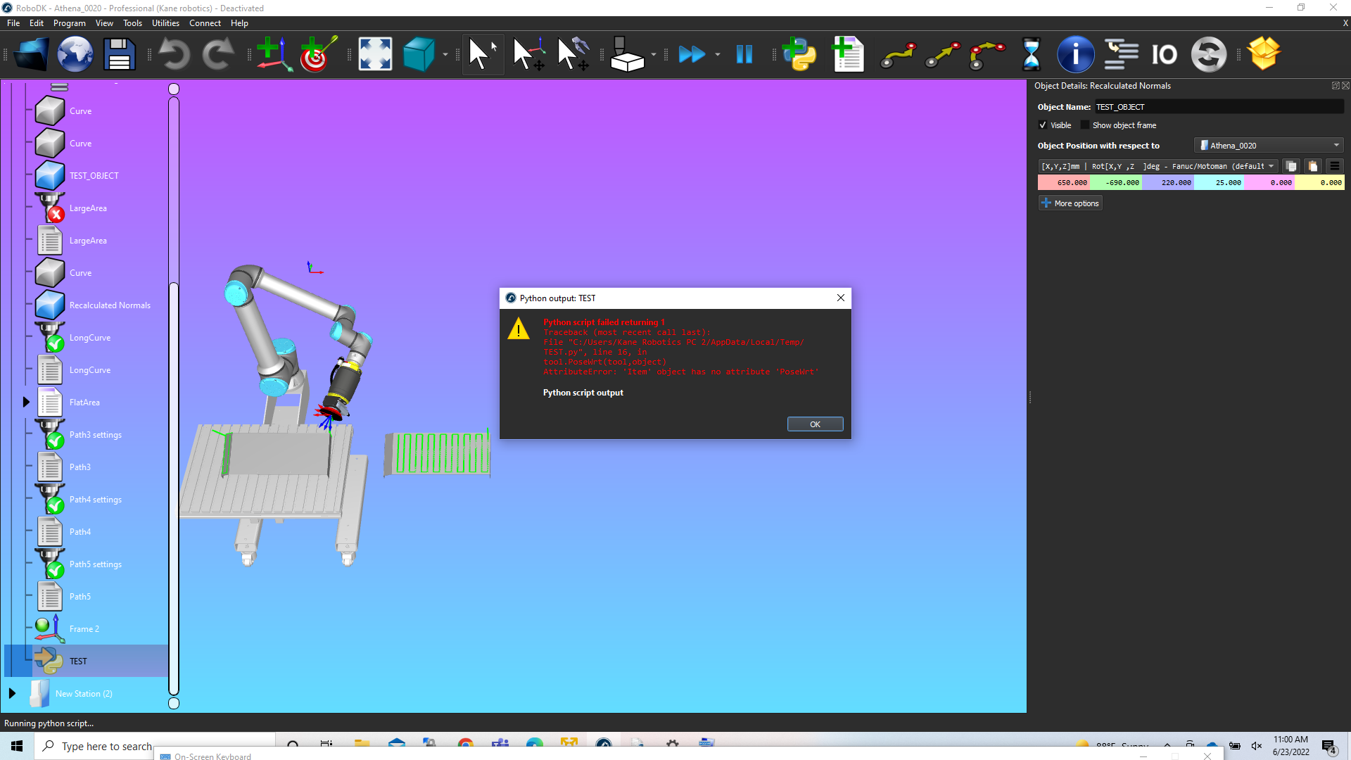

I'm trying to use the PoseWrt to function, but I keep getting an error saying "Attribute Error: 'Item' object has no attribute 'PoseWrt' ". I have attached a screenshot. If I use this function, will I be able to find the position of the robot (X,Y,Z) with respect to the origin of the part (step file)? That is what I am after.
As stated above, this is fairly new, and you might need to manually update the RoboDK API in your install folder (C:/RoboDK/Python), wait that we bundle it with RoboDK in a future update or copy the code from the GitHub repository in your station.

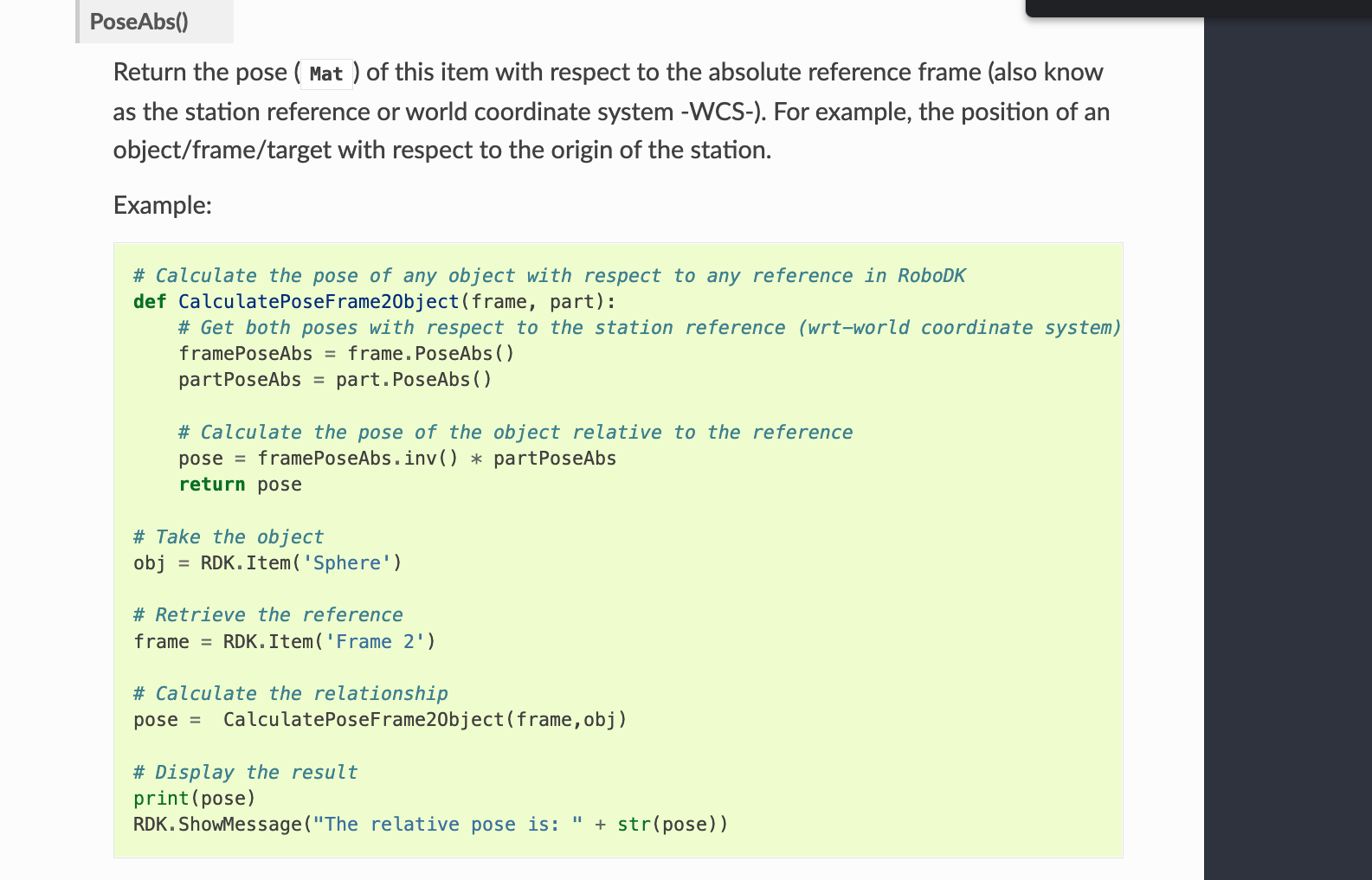

I did find a script in the RoboDK Python API that calculates the pose of any object wrt to any reference frame in RoboDK. Is there any way to modify this to give me the pose wrt to a reference frame of every waypoint in a path?
I attached a screenshot of the script I found.
