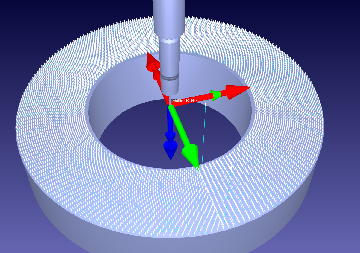

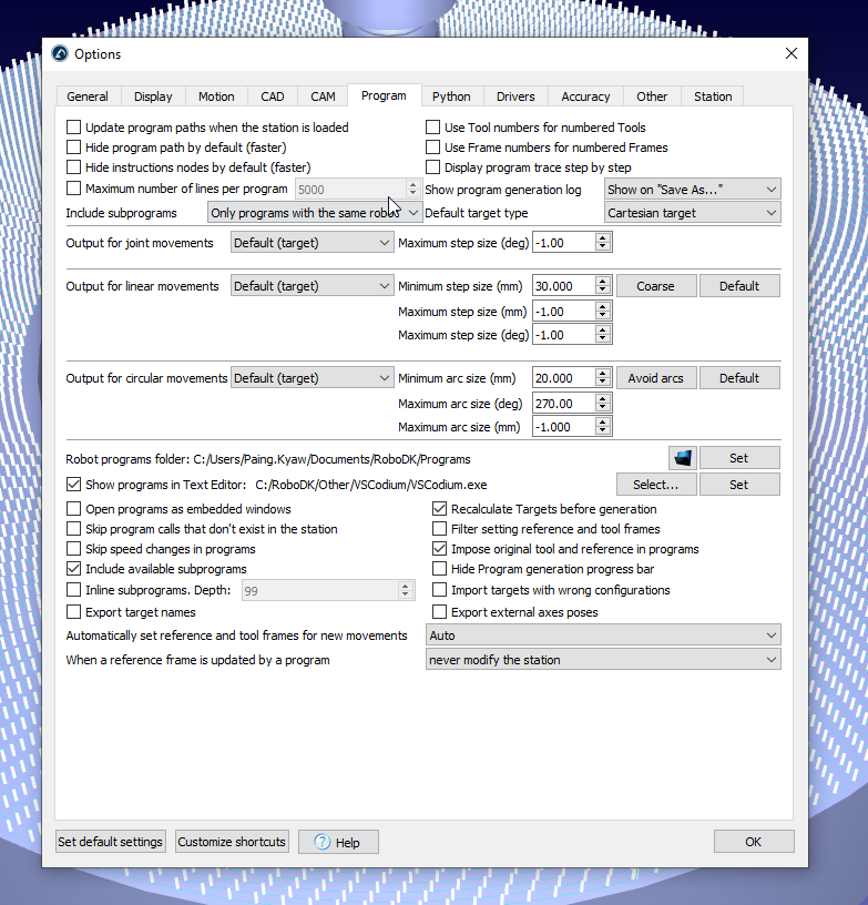

Hi, I have a problem with generating programs for circular movements as i need to minimize the points when the robodk generating linear movements. I have attached the curve and setting screenshots.

2024-02-09 08_36_57-RoboDK - 3G DOG BONES RINGS .png    2024-02-09 08_40_13-RoboDK - 3G DOG BONES RINGS - Professional .png
The Program settings affect only program generation. RoboDK will still import all points from your NC files (G-code, APT, NCI, etc). However, the filter will be applied when you generate the program for your robot controller.

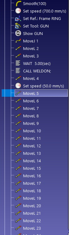

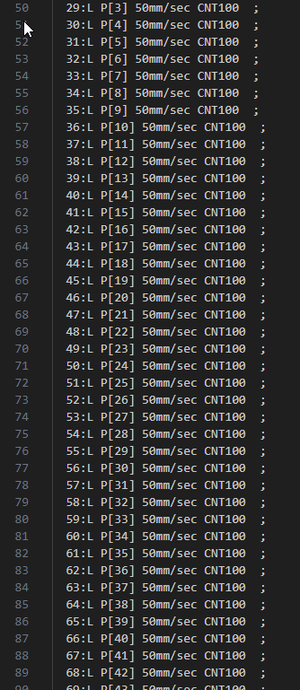

Yes I am having trouble generating programs with move C as a LS files.
The number of points it is making with moveL is more than my robot controller can store.
I have to reduce the number of points.

2024-02-12 11_02_39-RoboDK - 3G DOG BONES RINGS - Professional.png    2024-02-12 11_06_15-GDBBSR2.LS - VSCodium.png
If you obtain large programs, it should be easier to load a large program split into smaller programs for certain Fanuc controllers.
To solve this issue, you can split large programs into smaller subprograms by following these steps:
https://robodk.com/doc/en/Robot-Programs...ogramSplit
We also have a post processor called Fanuc_RJ3_DripFeed which allows you to remotely send the subprograms of a large program to the robot controller as the robot executes the program.
