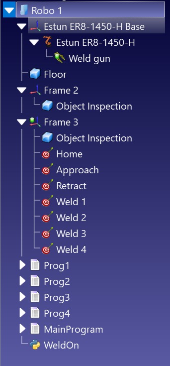

Can I simply copy and paste all the settings from my first robot and apply them to the second robot, changing only the robot model itself? This would ensure a more accurate comparison between the two robots. I have attach my settings
You can easily replace the robot at your station.
