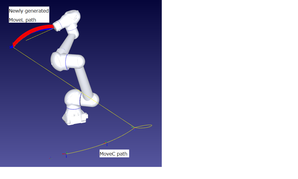

I tried converting MoveC to MoveL using C:/RoboDK/Scripts/MoveC_2_MoveL.py .
However, the generated MoveL program drew a different trajectory from the MoveC program.
Could you please give me some advice to solve it?

Circular movements require first moving to the start point. This point is not clear in your first program.
To solve this issue you simply need to add a joint movement to the first point. You can see the fix in the attached example.
