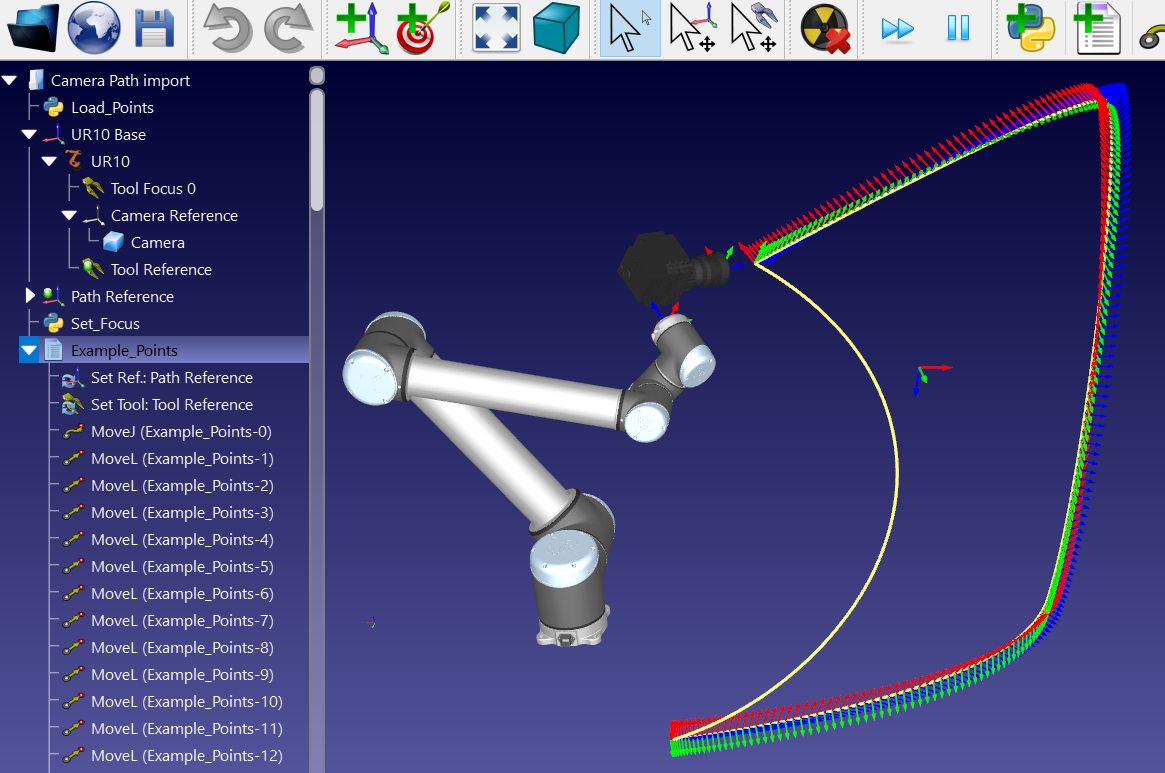

Also, I attached an example project that allows importing a list of points in RoboDK, automatically creating targets for each of the points and a program. The targets are created on the "Path Reference" coordinate system and it allows you to adjust the position of your targets.

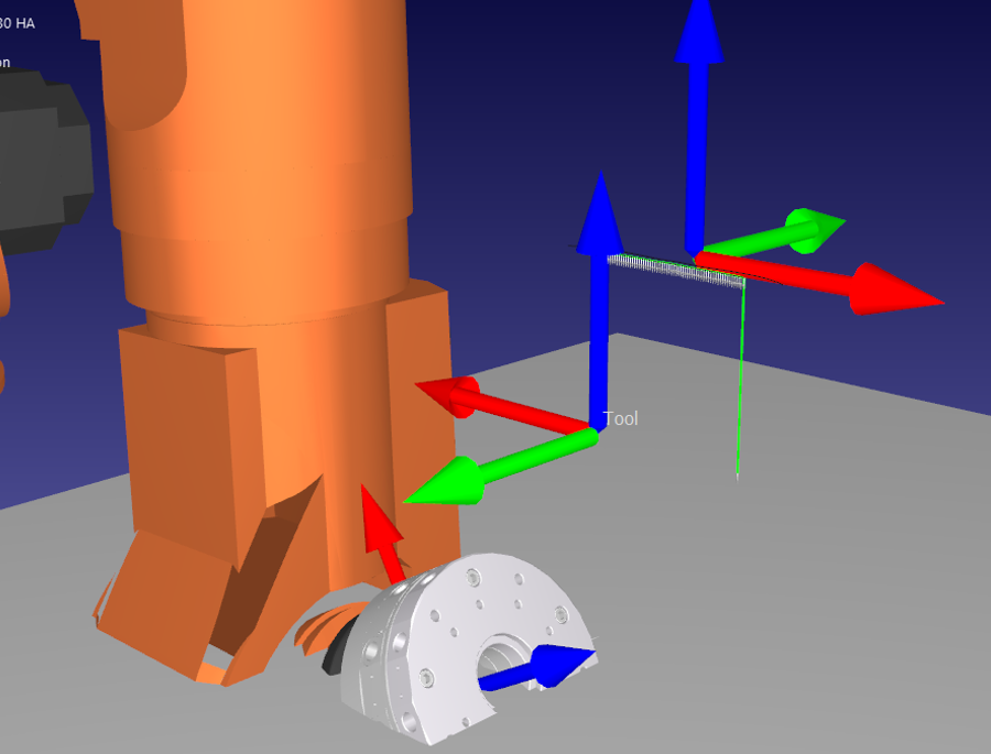

Hi Albert, we have tried to customize the script to Euler format using the same equations you have in the PythonAPI, but it looks like the direction is always opposite of the defined z-axis of the tool head (and also opposite direction of the z-axis of the path itself).
Here you can see that the white lines (arrows pointing downwards), while the tool z-axis and the part z-axis are both upwards:

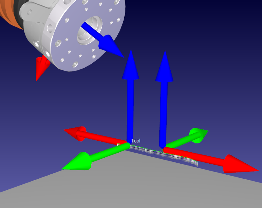

And here you can see that I changed the coordinate system of the tool, but the z-axis is still the opposite of the white arrows, and the "retract" and "approach" have to be in the minus direction too:
Is there a solution for this?
Thank you in advance.
You could flip the Z axis of the tool by applying a rotation of 180 deg around the X or Y axis. For example, if you want to rotate 180 deg using the API this would be:
pose = KUKA_2_Pose(xyzabc) * rotx(pi)
Can you share your RoboDK project file, the script and the file you are trying to load? We can better take a look.
