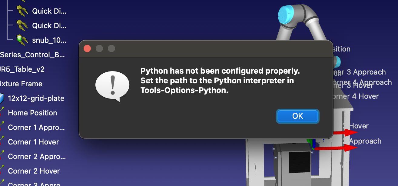

Issue Generating Robot Program on M1 Mac, Sequoia 15.3.2
When I try to generate robot program, I get a pop up saying Python has not been configured properly. I tried following the solution given in this post, https://robodk.com/forum/Thread-Unable-t...ams-on-Mac, but I have had no success. I've tried Python versions 2.7, 3.11, and 3.13 but get the same pop up regardless.  Screenshot 2025-08-04 at 8.49.28 AM.png    .
I've also tried changing the Python interpreter to the location of Python found when I search in my Mac's terminal, /usr/bin/python3 with no luck. Any suggestions are appreciated. Thank you very much for your time!

This issue has been fixed with the latest version of RoboDK.
I recommend you to use the "open" command to edit Python scripts. It will open the default application associated with Python files.
You can take the latest version from the download page:
https://robodk.com/download
Thank you!! Using "open" for editor under Options->Python and Options->Program was necessary for me; paths didn't work.
