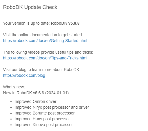

Please confirm that when I click the download button I am downloading the correct version
(02-01-2024, 02:35 PM)PelevinGY Wrote:
(02-01-2024, 02:14 PM)Sam Wrote: The JAKA documentation is over 2 years old. We have since partner with them to officially support JAKA.
Please use RoboDK's official documentation to set up your JAKA robot:
https://robodk.com/doc/en/Robots-JAKA.html#JAKA
If you manually copied files to the RoboDK installation folder to follow the JAKA instructions, delete them. Updating RoboDK will not remove them.
Once deleted, install the latest version of RoboDK (currently v5.6.8 released on 2024-01-31).
Note: your first screenshot uses the "DobotDriver.exe", not the "apijaka.py".
Please confirm that when I click the download button I am downloading the correct version,
because when I download the version from the site I get a completely different release
Checked the relevance of the RoboDK version
