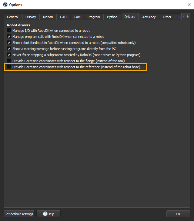

Hi Alumill,
I have another potential solution for you, could you try activating this option here:

Sorry for the late answer.
The new driver does not fixes the problem, same behavior.
