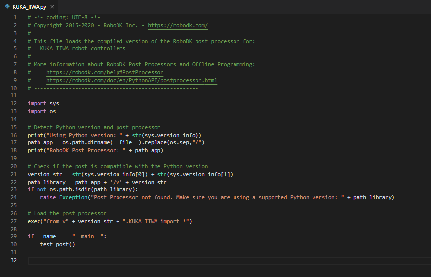

Previously I worked on the post processor of an UR10 and the UR10 was quite easy to modify.
That of the Kuka IIWA does not allow me to directly add / modify code.
If I understand correctly, the latter imports the information by "sys" and "os".
Where can I find these files?

Hi Albert,
Thank you very much for the KUKA_IIWA post processor.
For the sub program, I followed the procedure as described in the following link (https://robodk.com/doc/en/Post-Processor...pleOneProg) but it does not split my program into a sub programs.
Do you have a solution ?

.py   KUKA_IIWA.py (Size: 19.38 KB / Downloads: 1,005)
I am trying to help me with the kuka KRC2 post processor to integrate the MAIN and SUB_PROGRAM part to the IIWA post processor but it cannot be found in the source folder "Posts" (see attachment).
At the same time I tried to uncompile the KUKA_KRC2.pyc post processor but once transferred to a .py file, it does not work in RoboDK.
Where can I find the original program?
Cordially.
Jerome

Hi everyone, I have been solving the same problem for the last two days. The .py file contains only a link. It is a pity that the files are compiled and cannot be edited. As mentioned in the video tutorial. https://youtu.be/lbycCDjtOnE
I see the ability to easily modify the postprocessor as a great advantage of RoboDK, which cannot be used in this way.
Hi NDivad,
We no longer provide the .py script with the default RoboDK installer.
But if you ask for almost any of them, we will provide it as I just did for Jerome.
