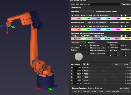

The problem is when we use Run-On-Robot with linear moves. The orientation of the TCP on the real robot faces the wrong way. In other words, the rotation values being sent directly to the robot are not the same as those generated by the post-processor. Some details:
The tool frame WRT flange is all zeros.
The reference frame WRT robot base is all zeros.
Default Euler angles in prefs are set to ZYX (Kuka/Nachi/ABB)
In the robot panel (screenshot) you can see that when tool-WRT-reference is set to display ZYX (Kuka/Nachi/ABB), and the rotation values are set at (-25,88,-30), then the tool is oriented correctly (X pointing down, Z pointing away from robot, Y aligned with world-Y)

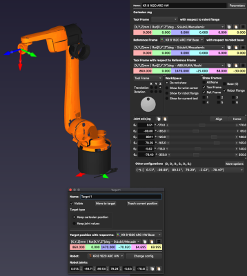

I made a target at that position/orientation and in the target options, by default, it displays Staubli/Mecademic orientation [ -70.91, 84.69,  69.99 ]. (I assume the combo box with different rotation order options is for display-only?
If we make a program with a linear move to that target, and save the program, the robot goes there just fine.
However, if we run-on-robot, using the apikuka driver, it faces back into the robot and the orientation values that we read on the teach-pendant are the same as those displayed in the target options when set to Staubli. i.e. X orientation on the real robot should be -25 but it is -70 and so on. If the roboDK robot is being driven by the real robot, it too faces backward and receives [ -70.91, 84.69,  69.99 ].
Just to make sure, we then entered by hand (-25,88,-30) on the teach pendant and the tool turned to the correct position.
So it seems to us that apikuka is the channel through which direct communication happens, and it is behaving differently to the KRC4 post processor.

I don't think so. The controller (KUKA KRC4) is receiving linear move values from RoboDK, and the translation component of those values is correct. The TCP goes to the right place. The problem is that the Euler rotation values it receives are in the Staubli/Mecademic rotate order, and therefore the values are completely different from the Kuka rotation order that the KRC4 is expecting.

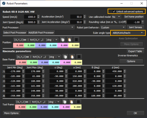

We just found the root of the problem.
You need to select the right Euler Angle format in the robot parameters.
See picture below:
That should fix the issue.
This seems to have worked! Thank you!
