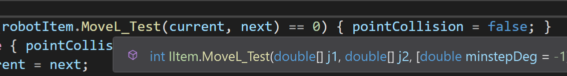

Hi all,
I'm trying to use the MoveL_Test function in a .Net application with the RoboDK API. I'm having trouble with an unexpected error.
The function (FunctionNetApplication.png) requires the joints of the two poses, when I use the joints of the second pose for j2 it returns the following error (error.png) which leads back to the MoveL_Test function.
Other references (like here *) suggest that the pose (Mat) should be used as the input of the end target.
Is it a mistake from my side? or is this a bug present in the .Net application?
(* https://robodk.com/doc/en/CppAPI/class_r...e983eaa692)
Kind regards,
Jan
