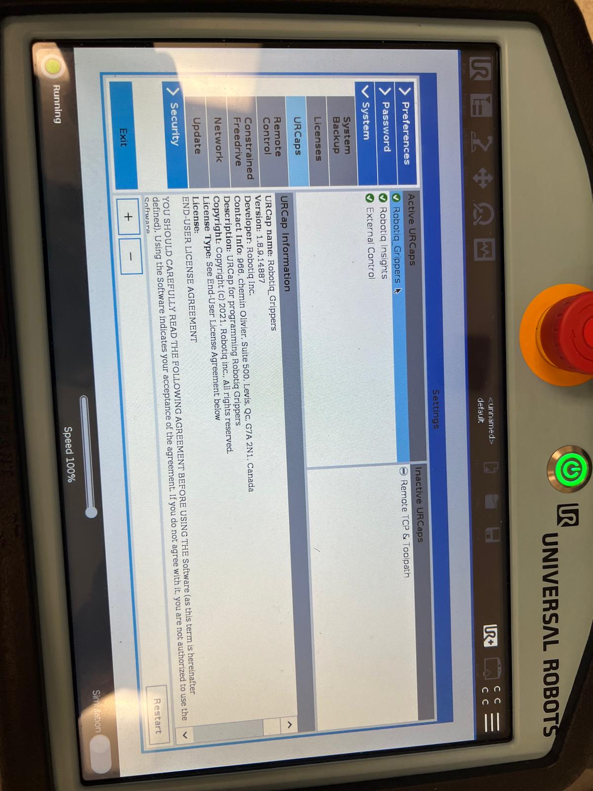

If you still have issues, I recommend you to check the version of the URCaps required by your RobotiQ gripper and any messages you see in the logs (RoboDK log or the UR robot controller). If you can send us your RoboDK project file we can help you better.

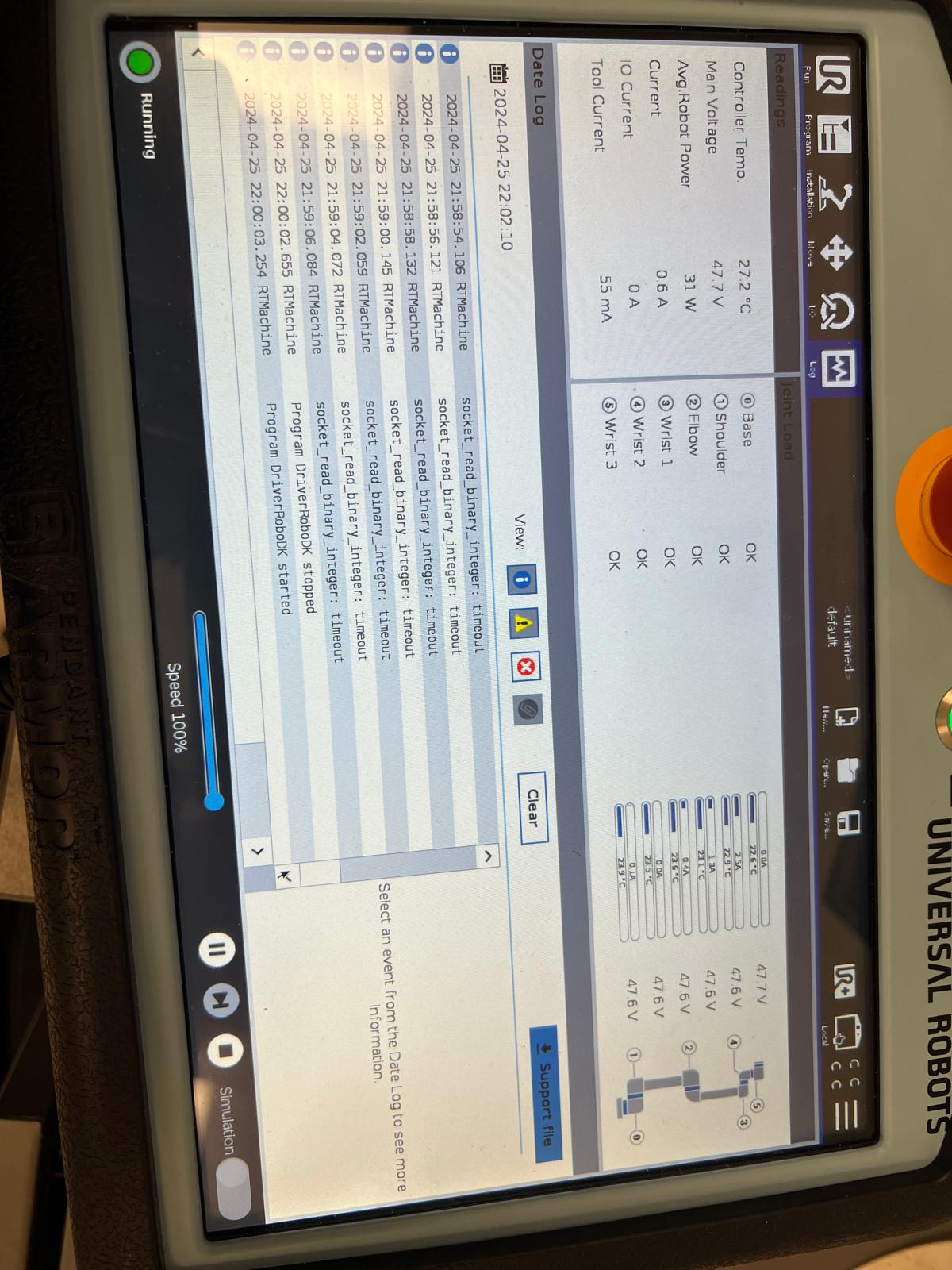

Hello Albert,
I tried checking the box you mentioned but there is not change. I can see that the gripper gets activated when I connect the robot but not able to receive the commands and wainitng until timeout. I send a previous message with the file and the URCAP version and log from my Teachpendant.

Can you share the log of the robot connection from RoboDK?

(04-26-2024, 08:43 AM)Albert Wrote: Can you share the log of the robot connection from RoboDK?
Did you place the progrobodk.script file in the RoboDK/bin directory?
Please check attached my Log file.

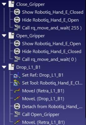

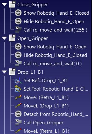

Hello, thanks it kind of worked I believe. But now the problem I have is that it only works for the sub-program (independently running the close or open gripper) but if I use the main program it does not call the subprogram and stays waiting for the instruction but does not perform. I could take out write the calls every time in each of the movements but not very efficient this approach. Is there some other setting I could try?
Never Mind I just created a new main program and now I am able to call the functions. Might be a bug or something but now it is working. thanks.
