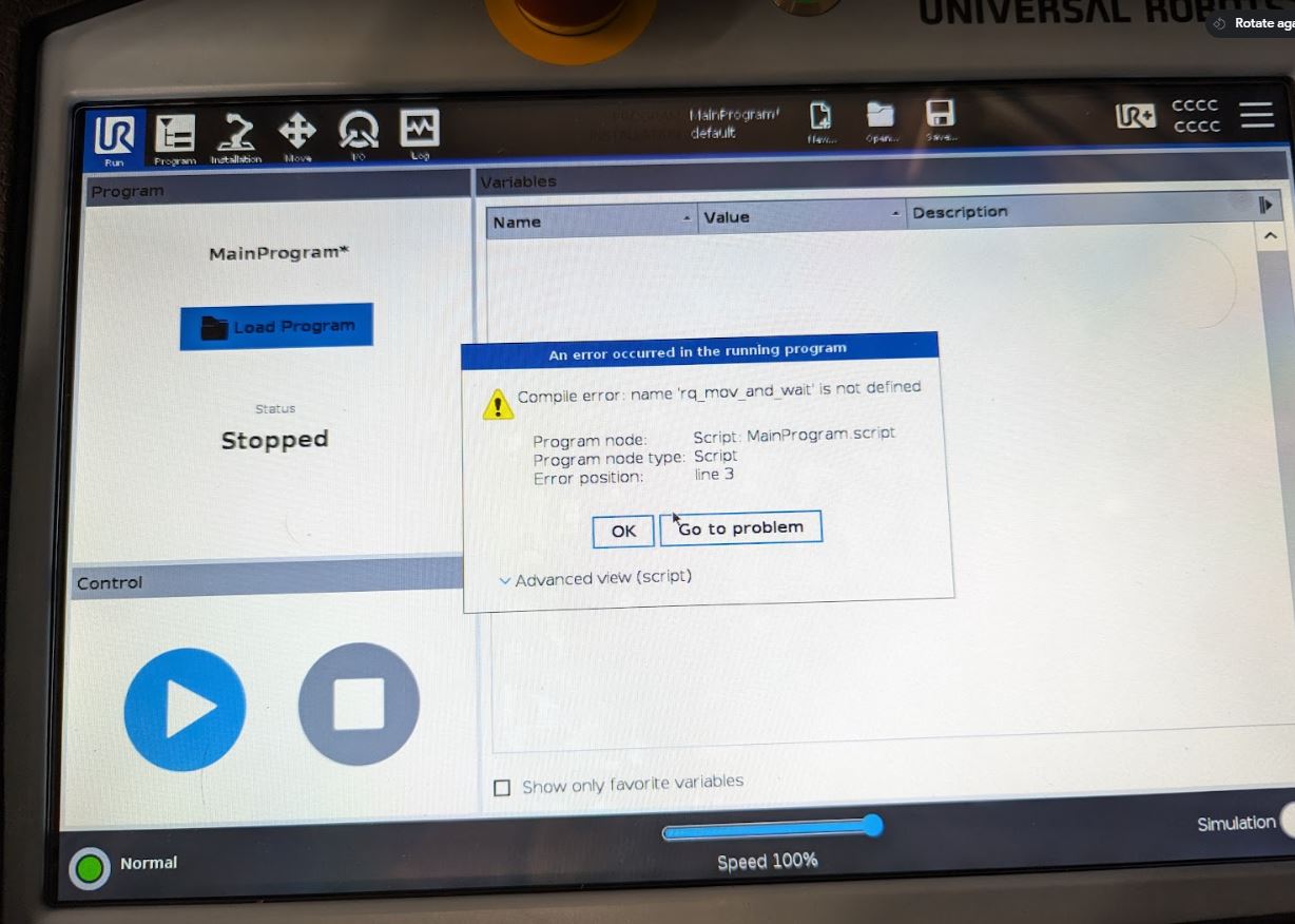

Hi Albert. I embedded those robotiq calls into the program and changed the post processor to Universal Robots RobotiQ. Those calls seem to be undefined. Here is the error it shows on the teach pendant when trying to run the program with those robotiq calls. It says Compile error: name 'rq_move_and_wait' is not defined. What am I missing?
Did you pass the parameter required? Can you share your RDK project?
