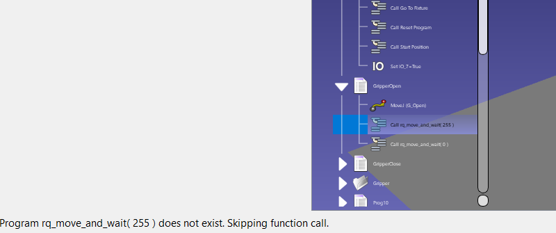

I am using RoboDK Python API to run my Robot UR10e and Robotiq Gripper 2f-85. UR10e movements are good enough but gripper integrations and control isn't working fine.
I have been following RoboDK and this Robotiq Gripper Integration and Control is more frequent problem in most threads. I am having the same issue, I have tried it with documentation of the RobotiQ Gripper but it's still not working.
rq_move_and_wait( 0 )
rq_move_and_wait( 255 )
These commands are not helpful. Nothing happens when we execute these files, infact RoboDK says no such program exists. (Reference 1.PNG)

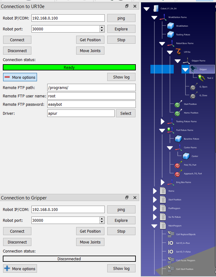

Secondly, as told by RoboDK Instructor, we need to add Robotiq Mechanism for Gripper, I added that but do we also need to connect it? (Reference 2.PNG)
I came to one other method of socket connection, but when I ran my script of Gripper Activate/Open/Close it perform the required movement of gripper only and result in disconnection with my robot connected via RoboDK (Reference 2.PNG) Ready state changed to Disconnect.
I also tried, RunInstruction('rq_move_and_wait(0), INSTRUCTION_CALL_PROGRAM), but no result.

Depending on the RobotiQ URCaps version you'll need different versions of the progrobodk driver. I recommend you to try this version:
https://robodk.com/forum/Thread-RobotIQ-...9#pid14629
You can also customize the header of the driver program to include the required script to drive your version of the RobotiQ gripper.
