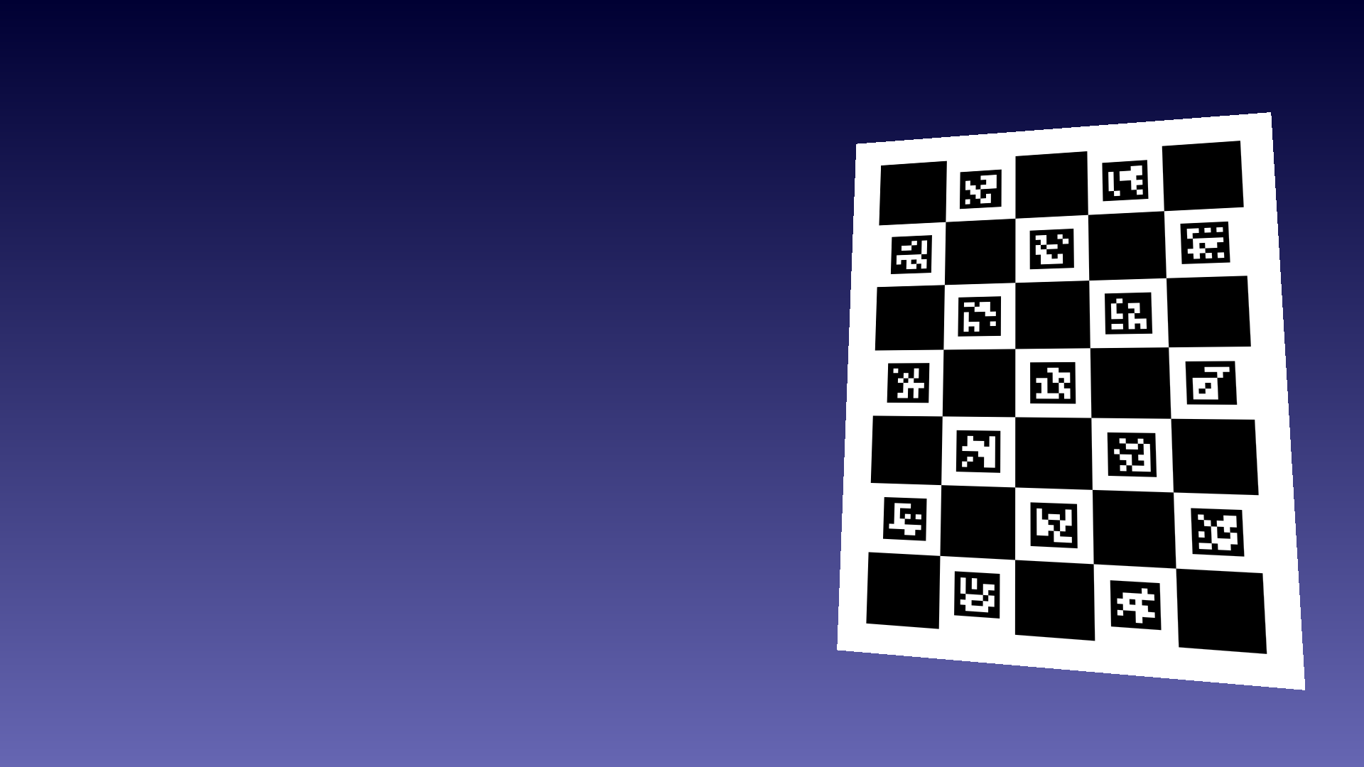

OpenCv CharUco Calibration

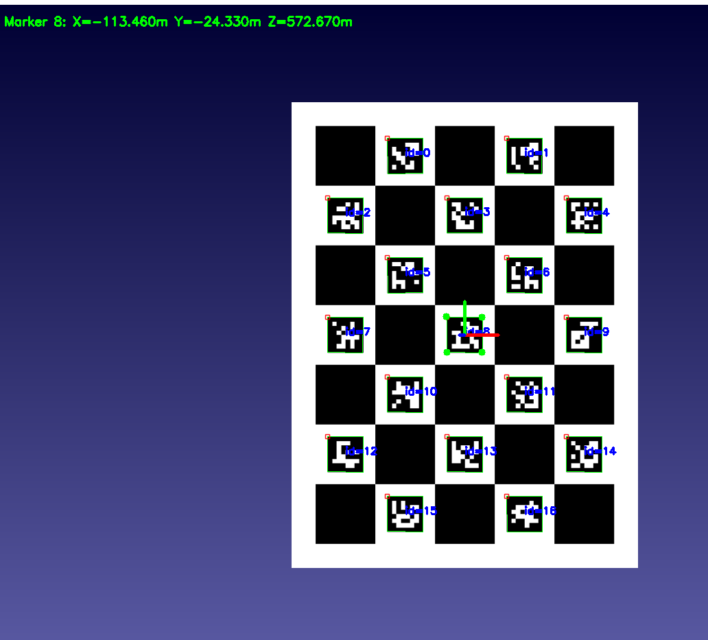

I am having trouble to get accurate pose estimation for the robot using OpenCV.
The calibration returns a sub-pixel reprojection of .05.
However, the positioning when searching for the marker is off by a few mm.

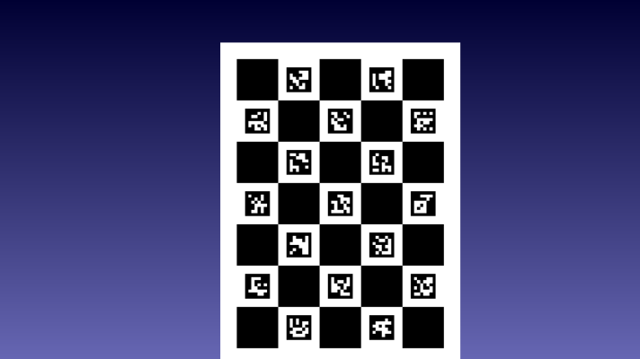

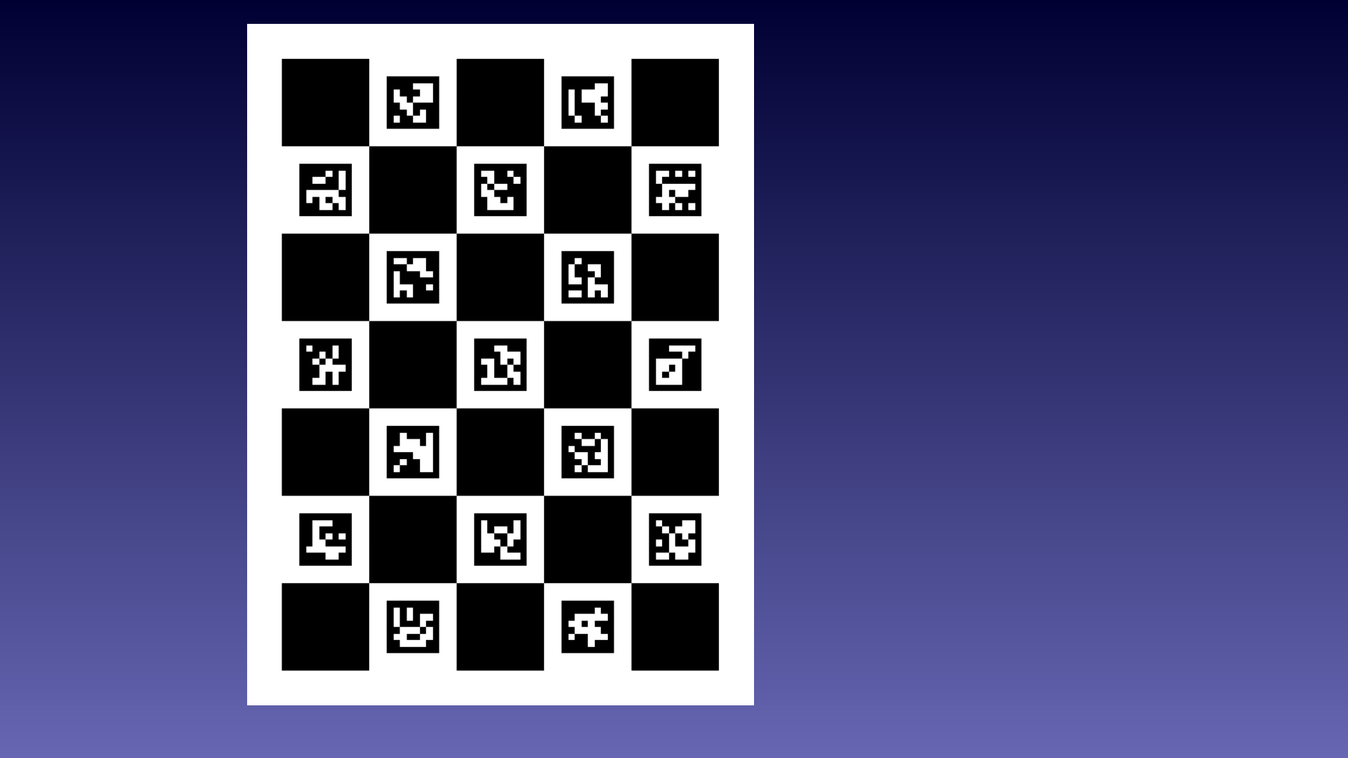

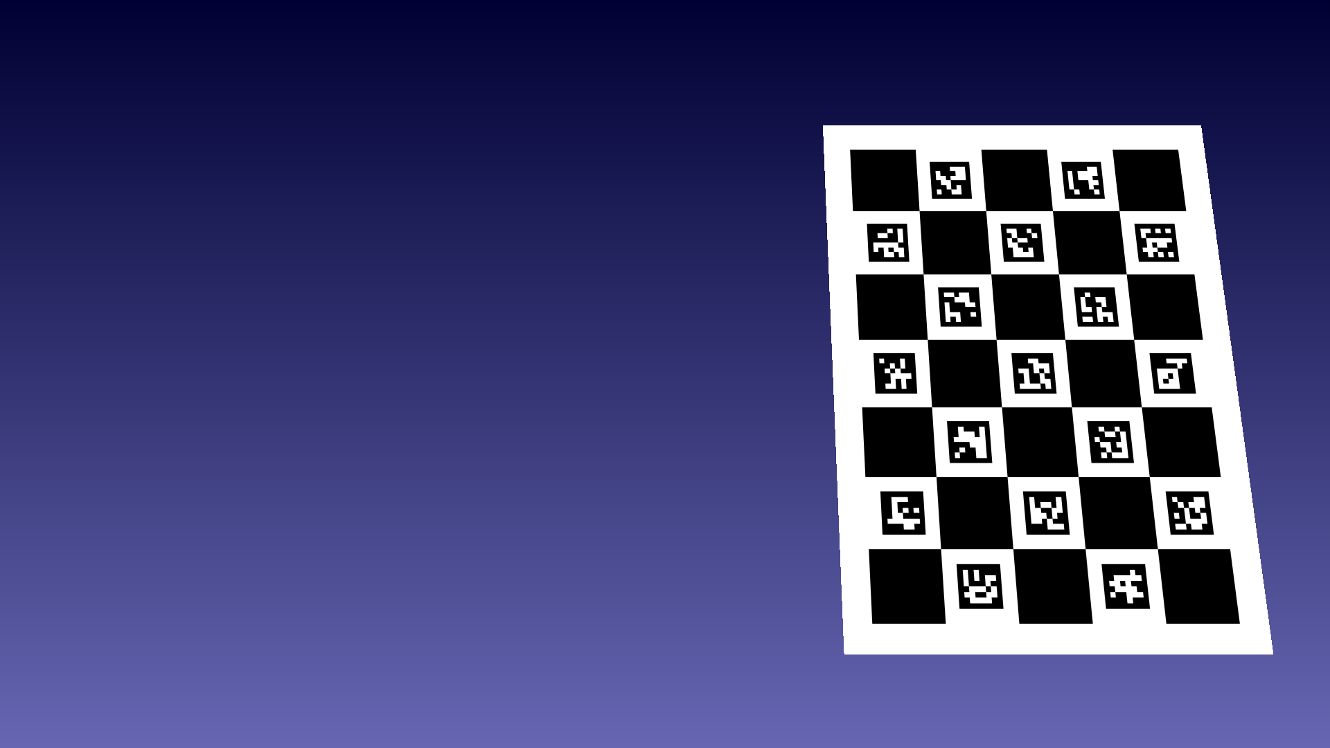

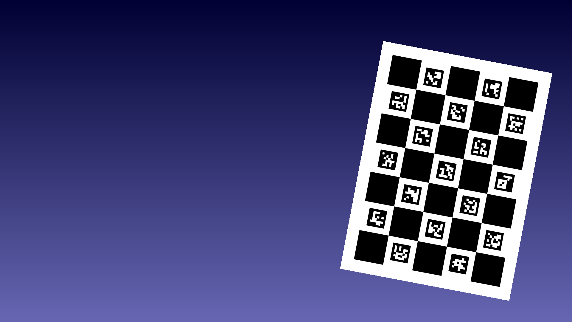

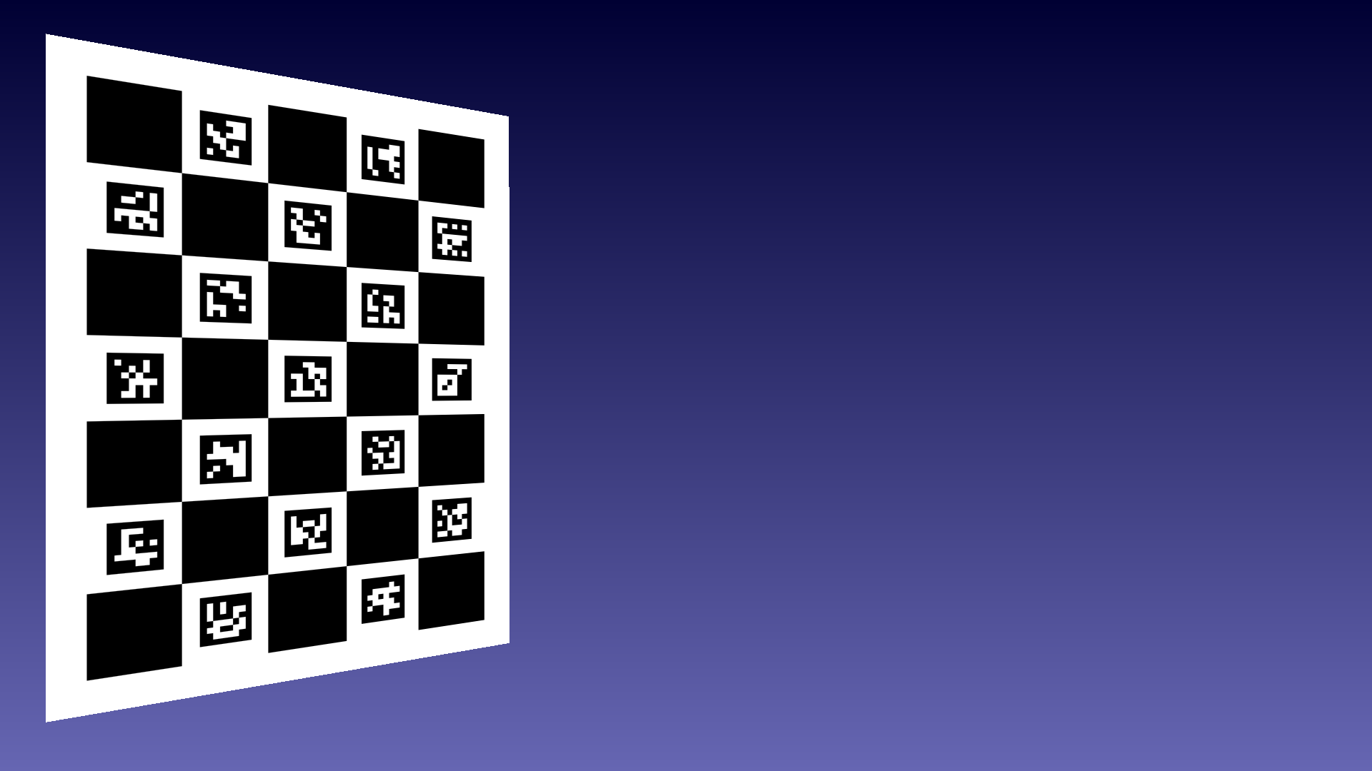

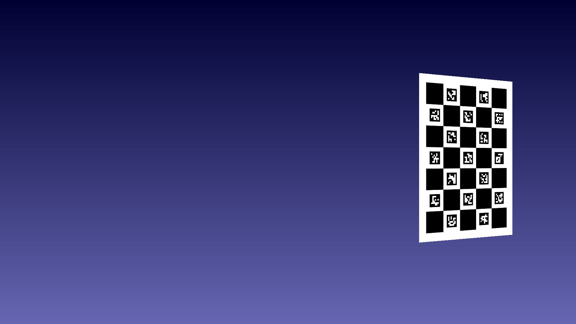

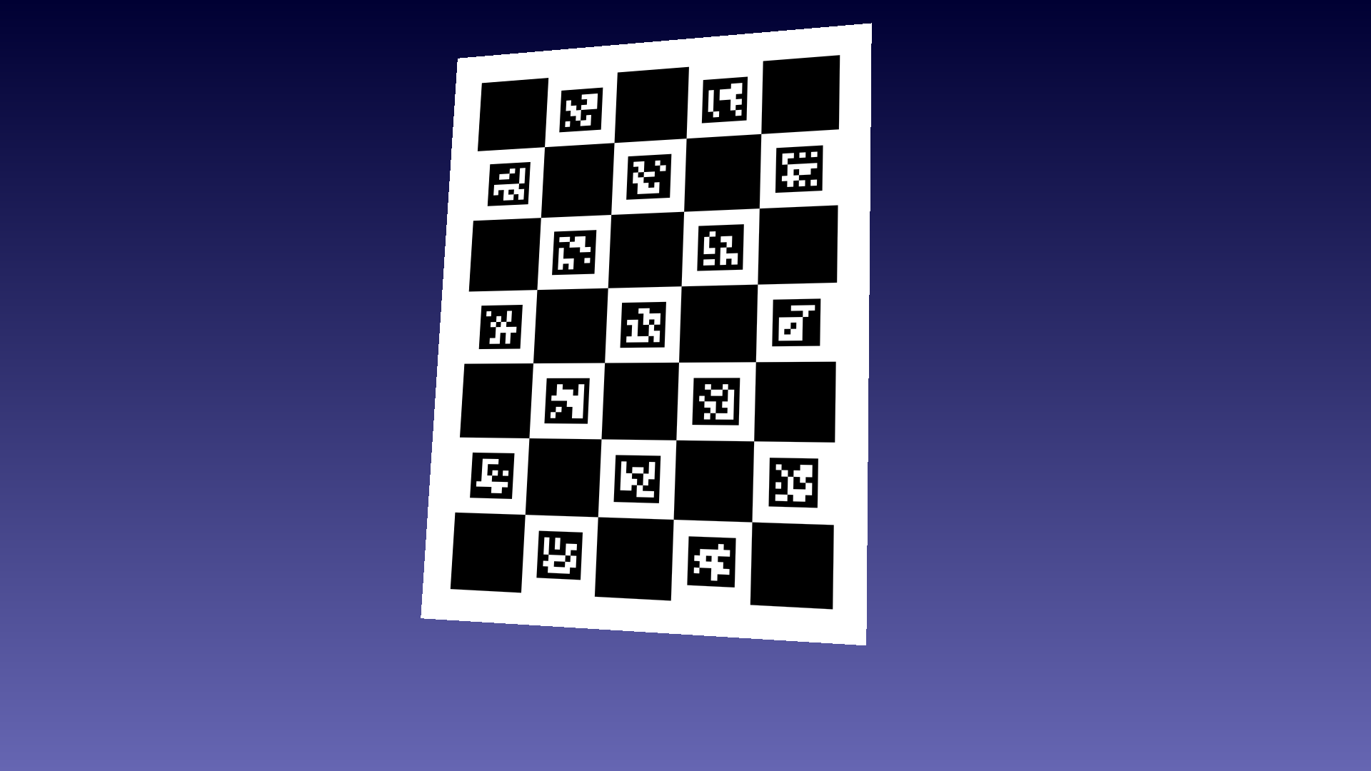

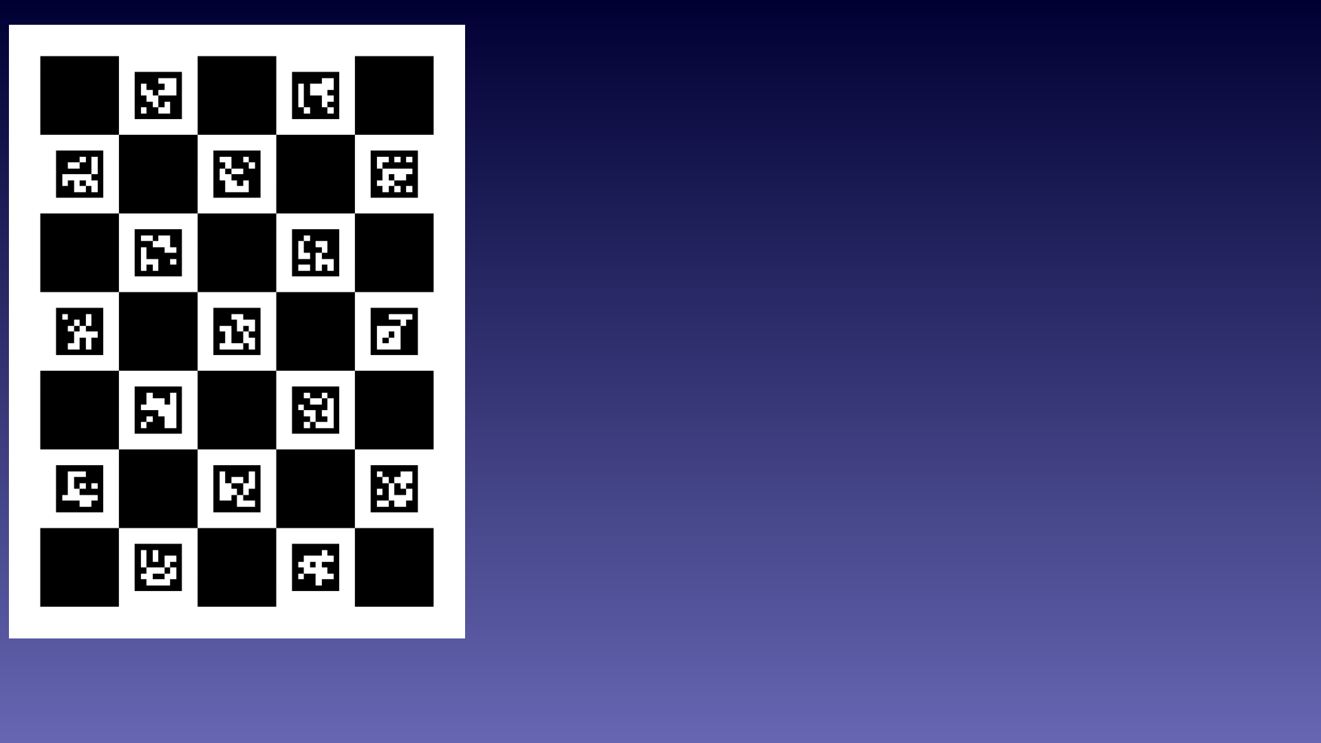

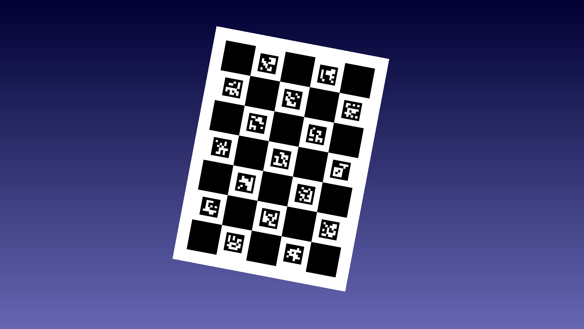

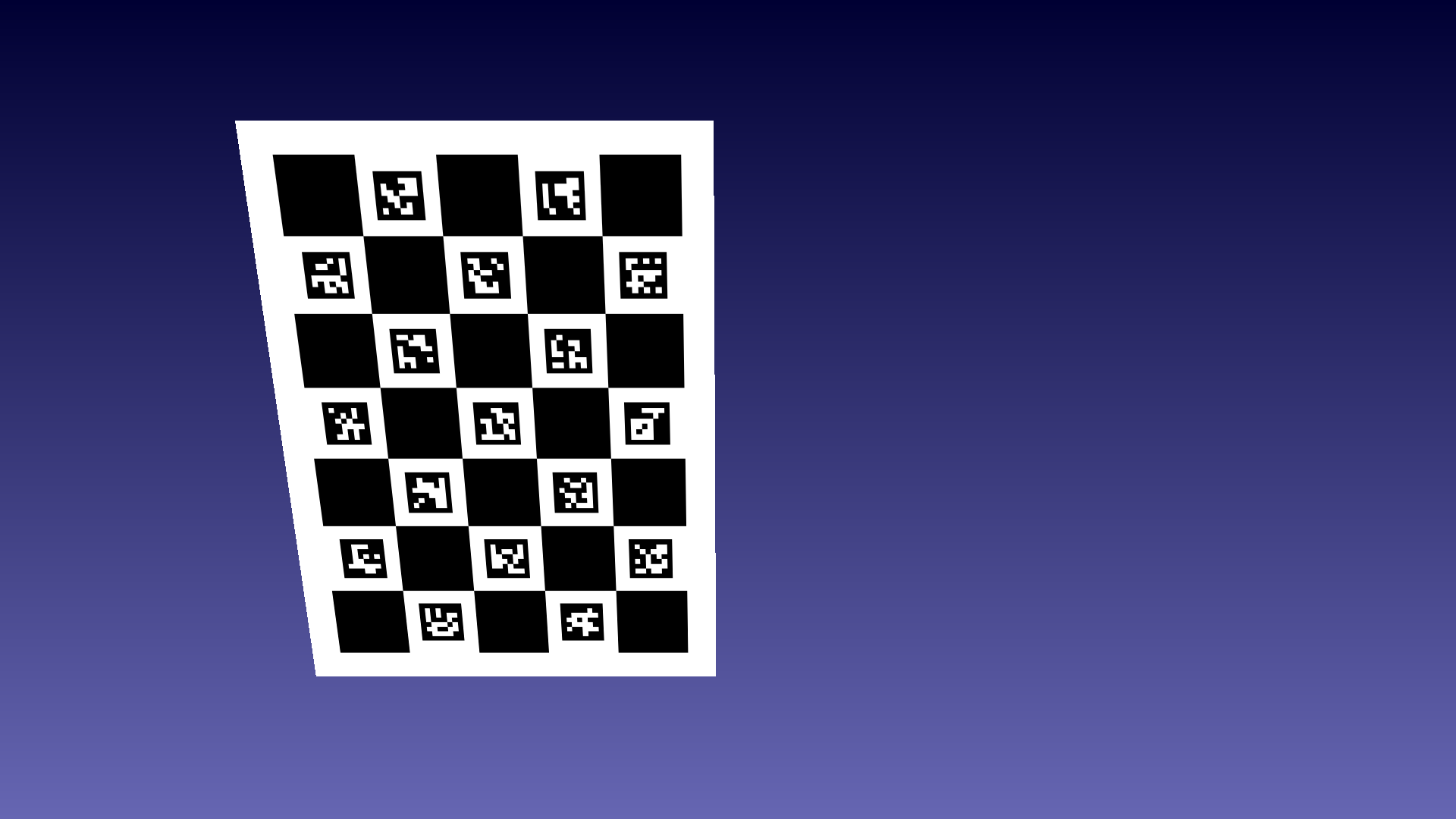

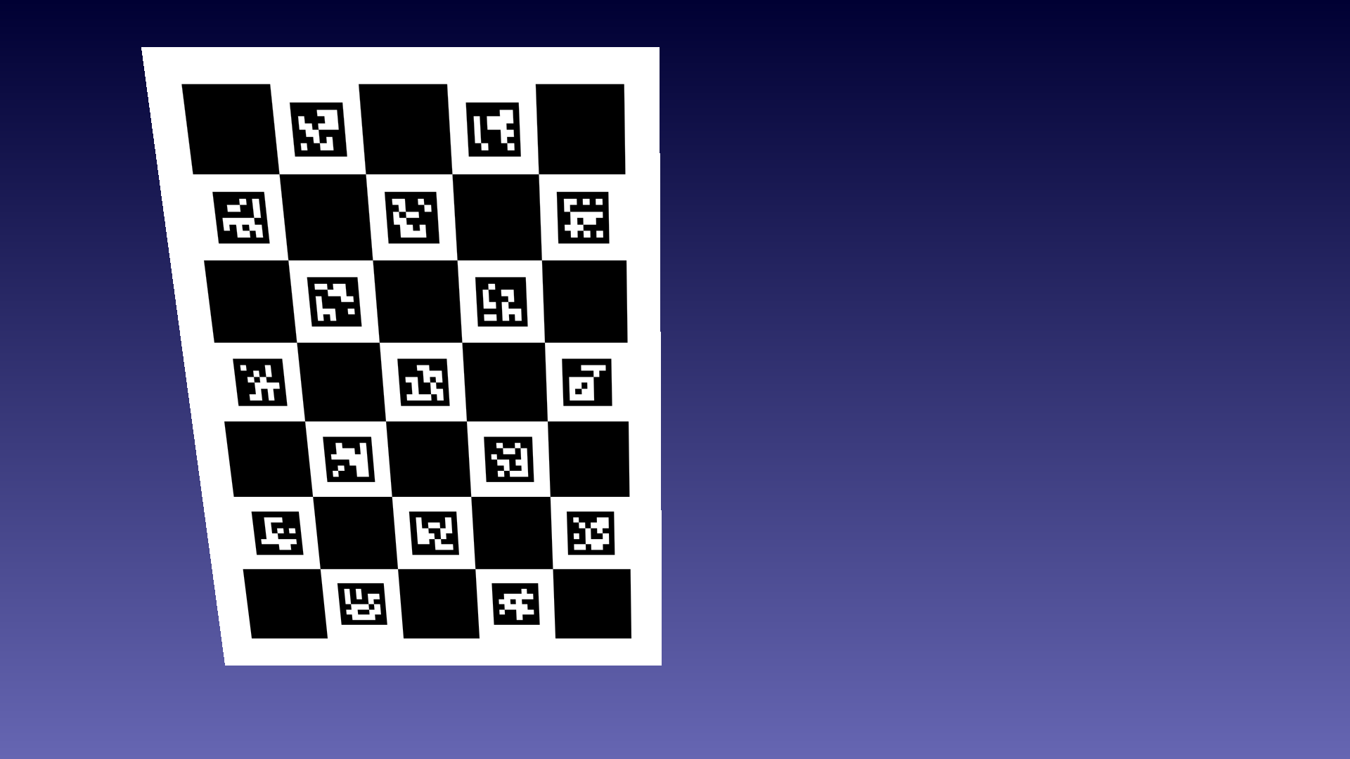

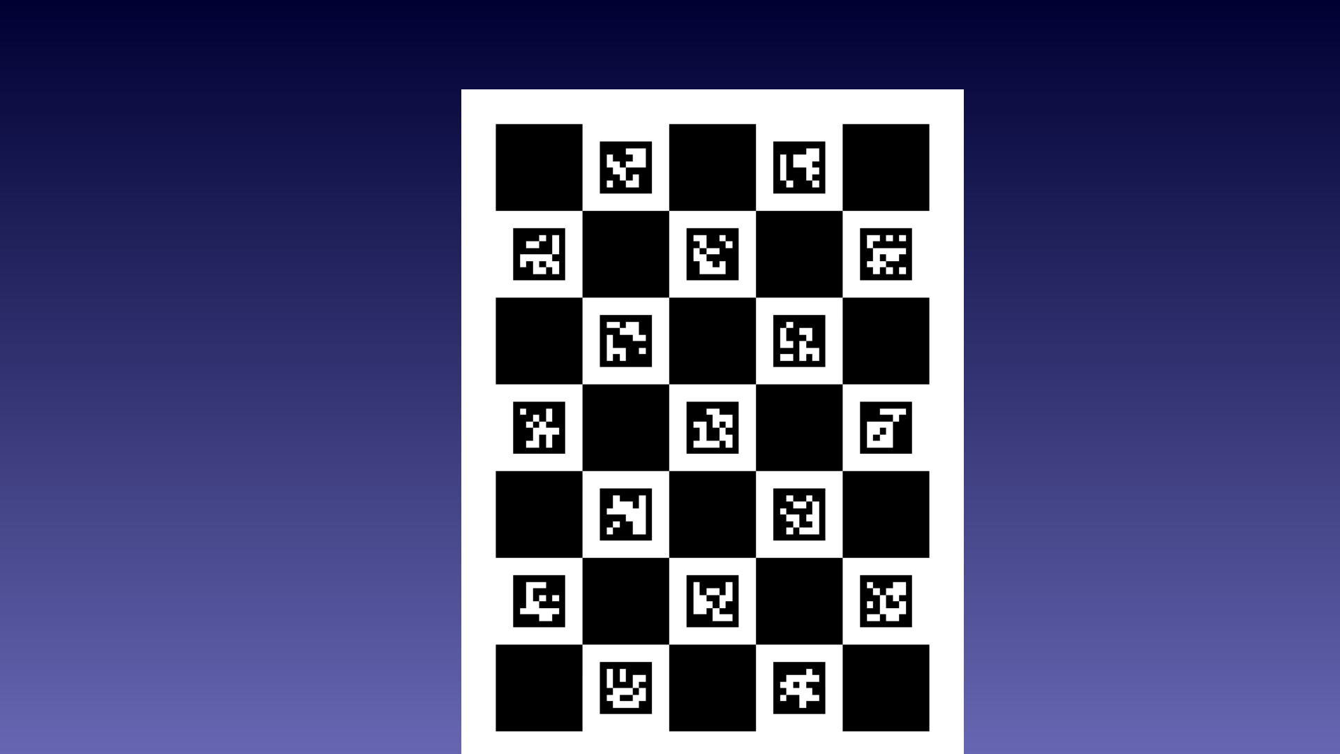

More pictures and xml:
Position  and code:
[Image: e1d4b6f7c35ff89bb3e31f5aeeab9d5a0988eaee_2_520x500.png]
RoboDK .rdk file attached
0.png    1.png    2.png    3.png    4.png    5.png    6.png    11.png    12.png    13.png    14.png    15.png    board reprojectiomn.PNG
.py   Step 1 Calibrate Camera File.py (Size: 4.16 KB / Downloads: 396)
.py   Step 4 Move Robot to Marker.py (Size: 6.81 KB / Downloads: 382)
.rdk   GolfPutty.rdk (Size: 1.76 MB / Downloads: 452)
I am currently looking into your issue and would need more information to properly find the root problem. Would you be able to tell us which version of OpenCV you are currently using? I would also recommend trying to spread out your targets for calibration more.
