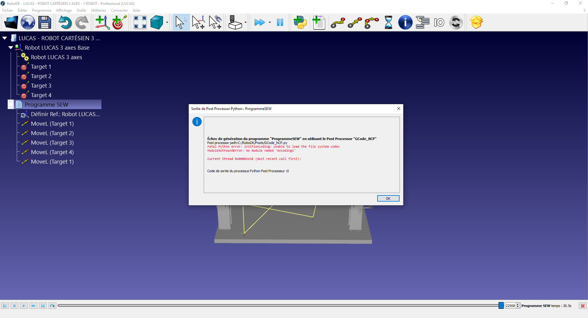

I want to generate a robot program using a G-Code post processor but there is an error appearing when I generate the robot program. Do I have to change something in the Python file of the post processor ?
Thanks,

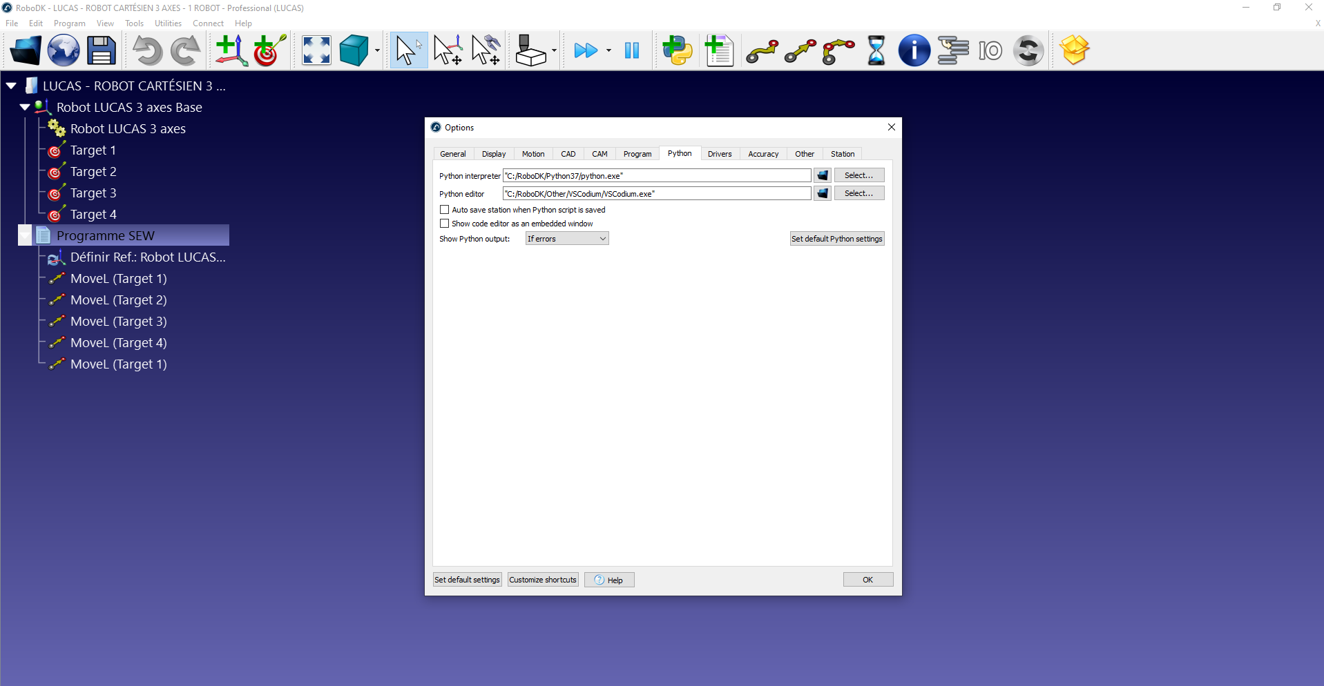

Are you using the python version that come by default with RoboDK?
In options->Python->Python interpreter, the path should be C:/RoboDK/Python37/python.exe

C'est étonnant j'ai toujours la même erreur alors que je viens de télécharger la nouvelle version de RoboDK et j'ai bien l'interpréteur Python dans ce chemin C:/RoboDK/Python37/python.exe
Yohan

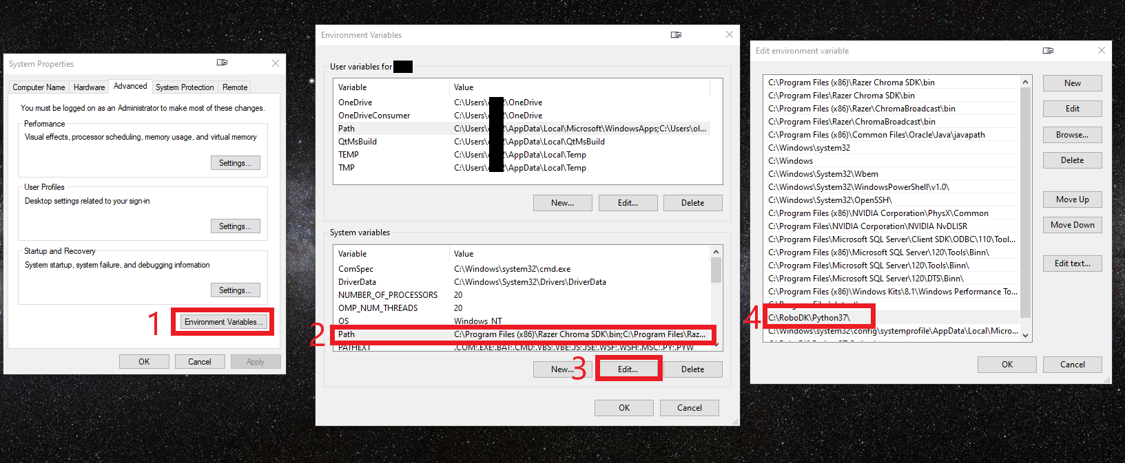

This is possibly a problem related to the environment variables of your windows.
Try this :
In the search bar, search for "Edit the system environment variables"->Advanced->Environment Variables->Go to the "System variables" window and select Path->Edit...->Make sur you have C:\RoboDK\Python37\ here.
I just changed the environment variables but the error appears despite the modifications :/
I would add a 5th step to Olivier's comments which is to reboot RoboDK after changing the path.
I did it but I still have the problem, do I have to change other environment variables ?
