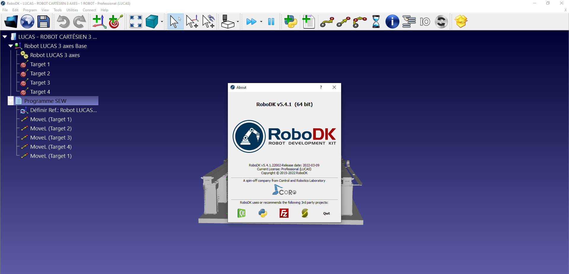

Problem when generating robot program |

Can you share the station?
03-21-2022, 01:56 PM
03-21-2022, 02:14 PM
It seem to be working correctly on my side.
Are you using the python version that come by default with RoboDK? In options->Python->Python interpreter, the path should be C:/RoboDK/Python37/python.exe
03-21-2022, 02:49 PM
Bonjour Yohan,
Est-ce que tu peux mettre à jour RDK si ce n'est pas déjà fait. Nous avons fait des modifications/améliration à notre API depuis le début de l'année et ça cause peut-être problème dans ce cas ci. Tout fonctionne bien de mon côté aussi. Jérémy
03-21-2022, 03:45 PM
03-21-2022, 04:15 PM
This is possibly a problem related to the environment variables of your windows.
Try this : In the search bar, search for "Edit the system environment variables"->Advanced->Environment Variables->Go to the "System variables" window and select Path->Edit...->Make sur you have C:\RoboDK\Python37\ here.
03-22-2022, 09:12 AM
I just changed the environment variables but the error appears despite the modifications :/
03-22-2022, 11:03 AM
I would add a 5th step to Olivier's comments which is to reboot RoboDK after changing the path.
03-22-2022, 01:13 PM
I did it but I still have the problem, do I have to change other environment variables ?
