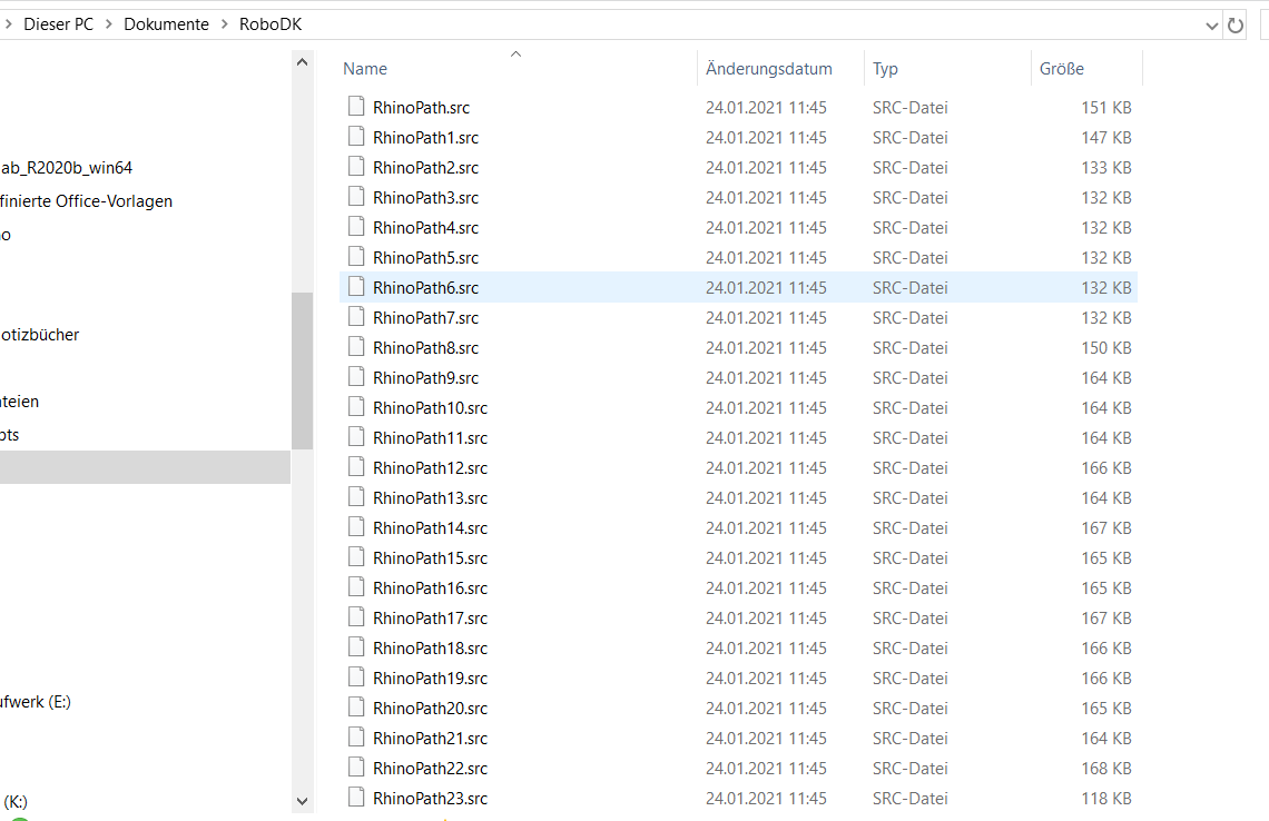

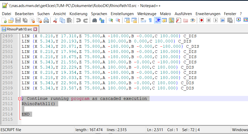

I have a question regarding exporting the robot program. I've created a simulation in RoboDK and would like to export this program to .src file for my KUKA robot. However, when I click "Generate robot program", the program was separated into 23 different files and each file has only around 2000 lines, as shown in the pictures below:
Is this "maximum line per file" set by default in RoboDK? I only want to have one .src file and not many files with limited lines. Would that be possible?

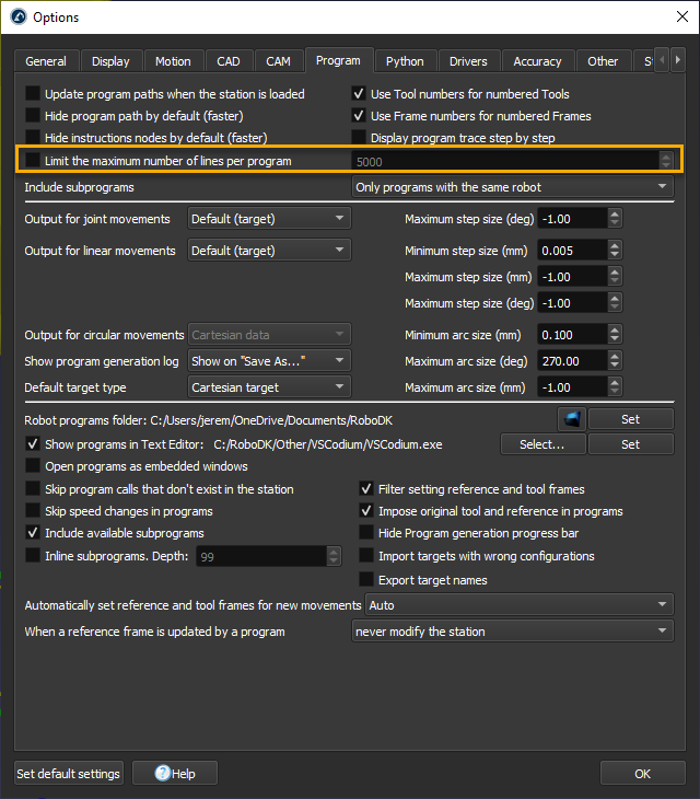

First, make sure that this option isn't activated:
"Tools"->"Options"->"Program"
If it isn't activated, just let me know which post-processor you are using and I'll fix that issue for you.

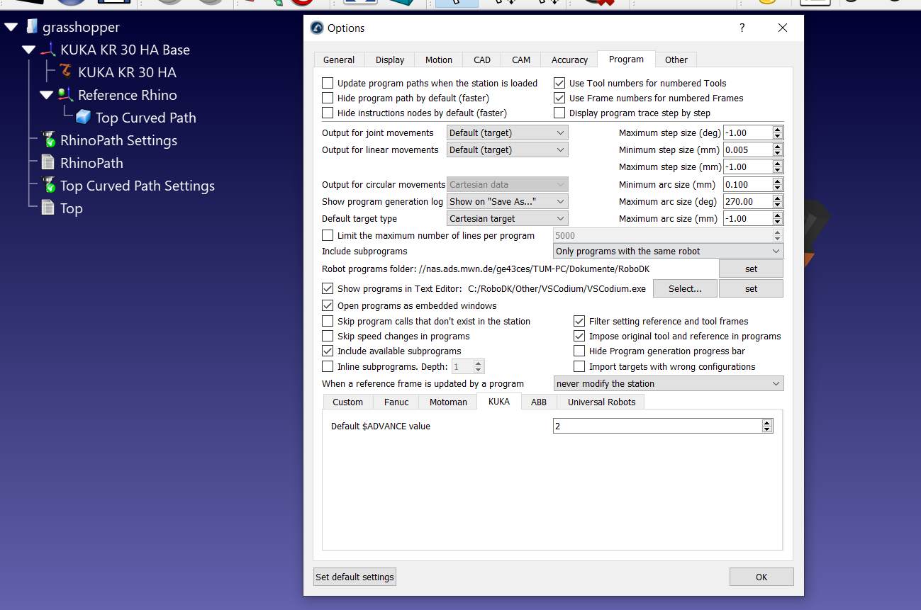

Hi Jeremy!
I've checked this option and it is not activated but still limits the line numbers per file, as shown below:

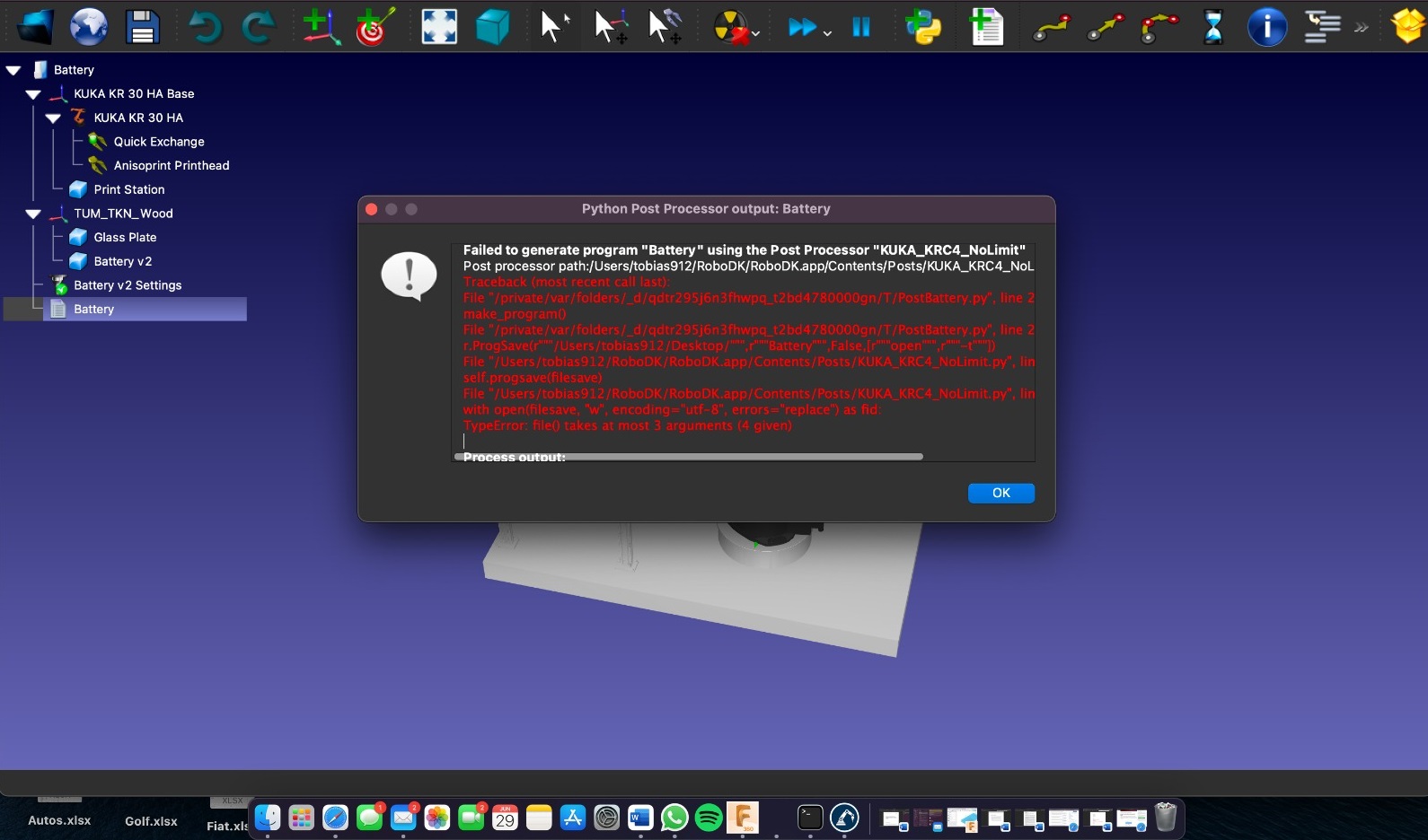

I am currently using RoboDK on MacBook, and I've also added your new "kuka_krc4_nolimit.py" post-processor into the post-processor folder of RoboDK. However, it is not possible to generate code with this post-processor, it always gives an error message, as shown below:
Do you know what the problem is?
(The Nolimit post-processor works really well on my Windows computer)
Robo
Can you show a bit more of the error message?
I'm not using MacOS and I don't have a way to test it right now.
