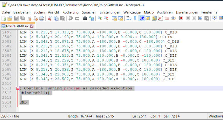

I have a question regarding exporting the robot program. I've created a simulation in RoboDK and would like to export this program to .src file for my KUKA robot. However, when I click "Generate robot program", the program was separated into 23 different files and each file has only around 2000 lines, as shown in the pictures below:
Is this "maximum line per file" set by default in RoboDK? I only want to have one .src file and not many files with limited lines. Would that be possible?

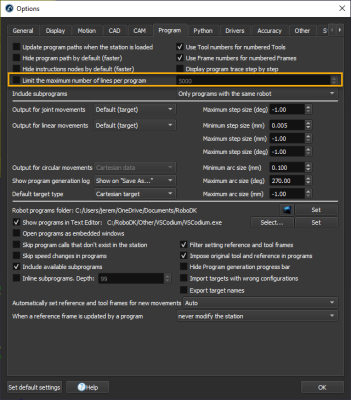

First, make sure that this option isn't activated:
"Tools"->"Options"->"Program"
If it isn't activated, just let me know which post-processor you are using and I'll fix that issue for you.

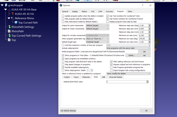

Hi Jeremy!
I've checked this option and it is not activated but still limits the line numbers per file, as shown below:
I am using KUKA KRC4 post-processor.
