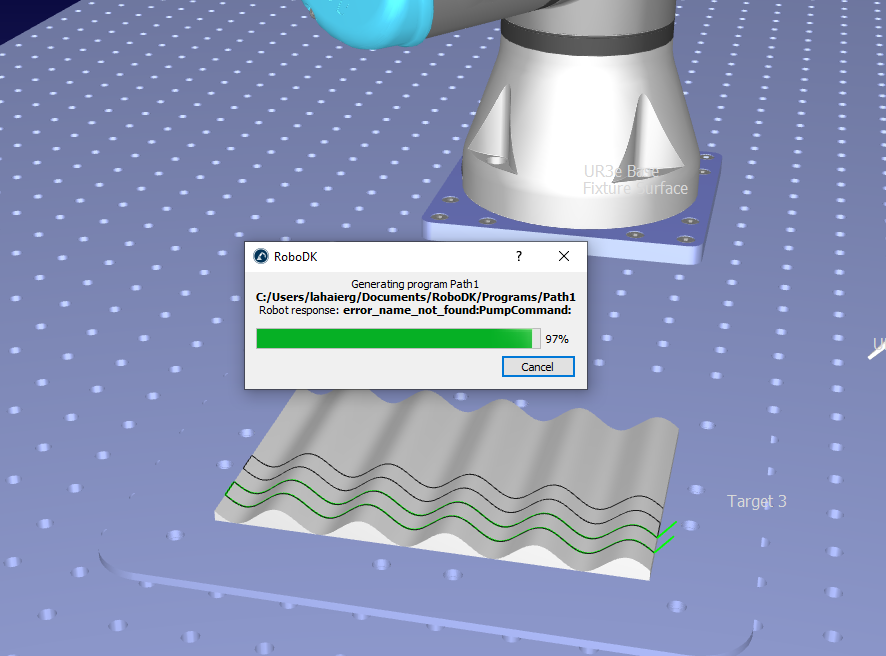

I am trying to call in a python script to turn on and off a pump that is being used in parallel with my UR3. When I send the code to the robot I get an error stating "Error_name_not_found". I have tried adding the call command within the movements of the curve follow program as well as making sub programs as shown in the spray painting example. The error and the .RDK file are attached.

Do you have the Pump Command function on the robot?
Python programs do not automatically convert into robot programs; if converted, only robolink methods are translated into the robot language.
If you want RoboDK to run the complete program (including Python), you might want to use the driver instead, however, this comes with other limitations.
(04-17-2023, 06:06 PM)Alex Wrote: Do you have the Pump Command function on the robot?
I have the pump command within the script in roboDK. Would I need to include the python script within the UR3 pendent as well?
What driver would I use with the UR3 to run the python scripts within roboDK? Will the driver still work if I use the UR3 MoveP post processor?
Thank you!
