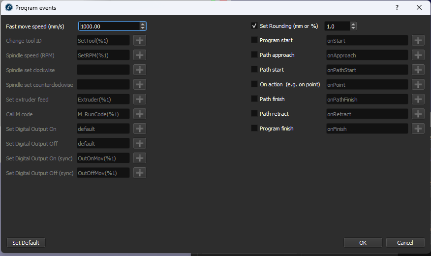

Hello everyone,
I am trying to configure a Machining item via Python API but I struggle to
1. set multiple approach/retract values as it is possible in the GUI
2. set Program Events like in https://robodk.com/doc/en/Robot-Machinin...vents.html
The .getParam() method on the name does only return b"", even if can be set.
I already tried different naming conventions (e.g. "ProgramStart", "PathApproach").
Is there a list of all the parameters and the expected formatting
Thank you and kind regards
Transformer
My current implementation
Transformer
