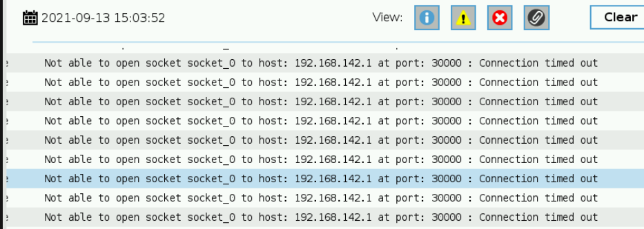

So we can ping, ftp, send programs to robot and retrieve position by using "UR active monitoring"-macro. But we are not able to create direct connection like "move joints" and "get position" or following movement on real-time with "UR active monitoring".
Error on the log:
"Not able to open socket socket_0 to host: 192.168.142.1 at port 3000 : Connection timed out"
Do you have any experiences with RoboDK over VPN and do you think it is possible?
Do you have any tips that I should look into with VPN or RoboDK configurations?
With straight connection from PC to robot with ethernet cable it works fine. I've also tried turning off firewalls.
