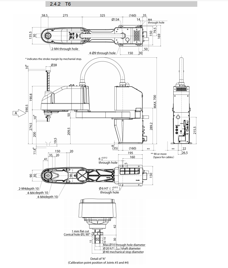

EPSON T6 3D Cad file and Specification sheets attached for your reference.
Please do the needful.
