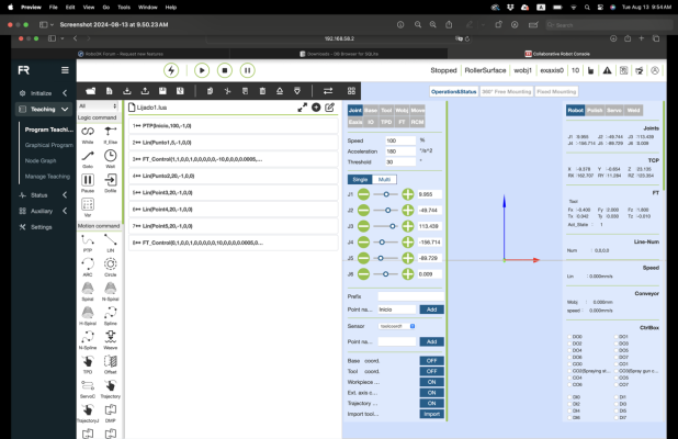

Sample of program with video
https://www.dropbox.com/scl/fi/0ut4d9nbh...5rq1u&dl=0
.tar   program_Lijado1.tar (Size: 60 KB / Downloads: 723)
