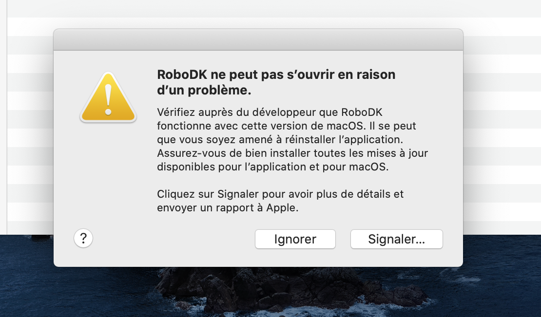

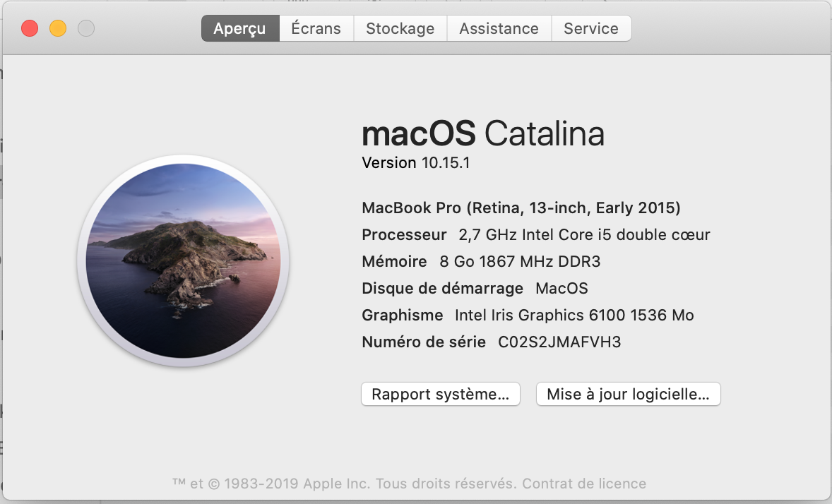

I installed the new update of RoboDK on my MacOS laptop but when launching, it raises an error (image enclosed). I run a MacBook Pro 2015 with the latest version of MacOS.
Thank you.
Marc

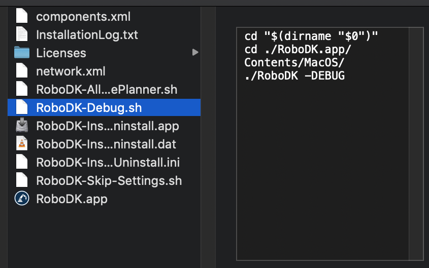

  1. Go to the RoboDK install folder (usually home/RoboDK/).
  2. Run the RoboDK-Debug.sh file (double click it). See image attached.

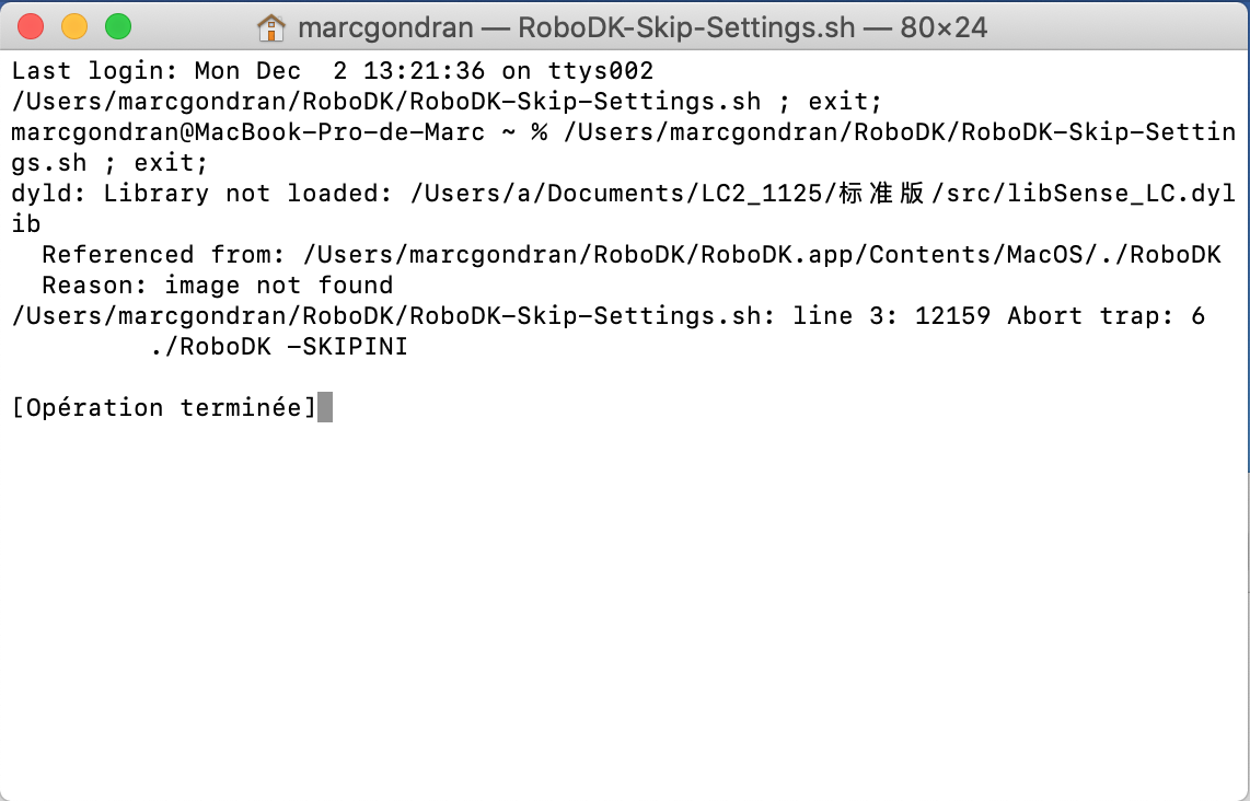

I've tried to launch RoboDK using the .sh script. It returns me an error shown. I attached the sreenshot.
Thank you

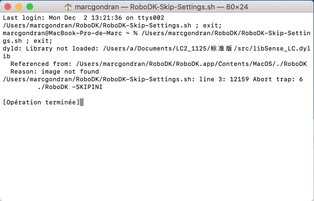

Here is the screenshot
There is no RoboDK.txt in the directory but there is a RoboDK executable which send the same output as in the screenshot
