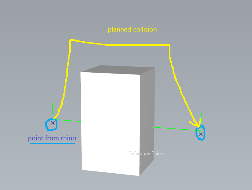

How can I plan collision by using points from rhino as input?

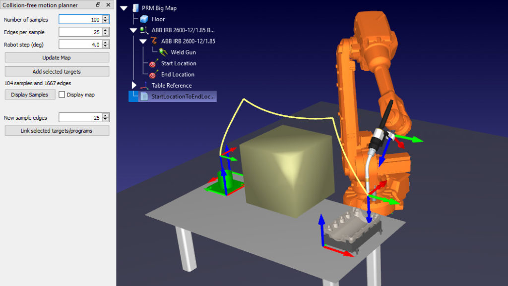

I recommend you to take a look at our Collision-Free Motion Planner plugin:
https://robodk.com/doc/en/Collision-Avoi...llisionPRM
Hi Albert,
I understand how Collision-Free Motion Planner plugin work.

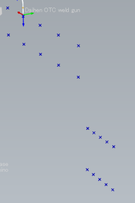

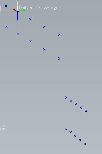

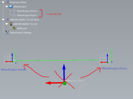

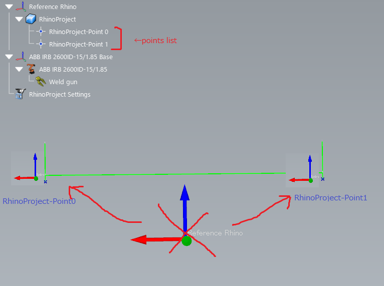

If I send points data from rhino, coordinate system is in the center of the point cloud.
But I want a coordinate system for each point.
Now, I can't set target on the point for this reason .
otani

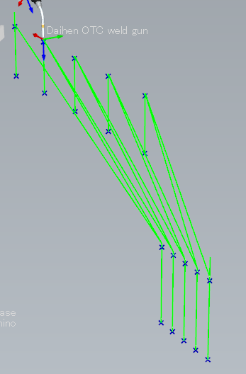

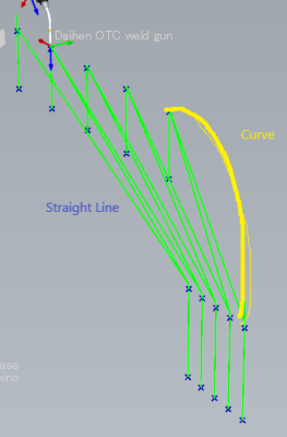

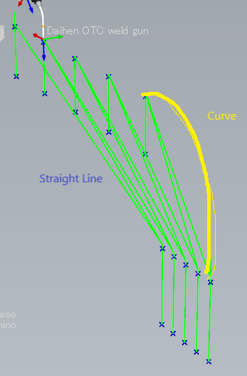

I tried to generate path from points data sent from grasshopper,but the shape of the path is only a straight line. Is it possible to generate curve to avoid obstacles from the points sent from Grasshopper?
p.s. I would like to read the program called RhinoPts Settings if possible. Eepecially regarding the process of generate a file named RhonoPts.

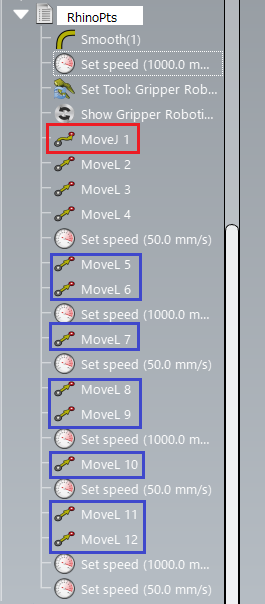

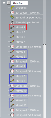

(06-09-2020, 08:15 AM)Otani Wrote: p.s. I would like to read the program called RhinoPts Settings if possible. Eepecially regarding the process of generate a file named RhonoPts.
Just I would like to change Linear move to joint move and insert gripper I/O command when import data from grasshopper.
Hi Otani,
If you prefer creating a curve it may be better if you load curves instead of points using AddCurve.
This example shows how you can modify the curve follow project settings:
https://robodk.com/doc/en/PythonAPI/exam...g-settings
This example shows how you can modify an existing program:
https://robodk.com/doc/en/PythonAPI/exam...structions
You can use RunInstruction after InstructionSelect to insert new program calls to manipulate your gripper.
