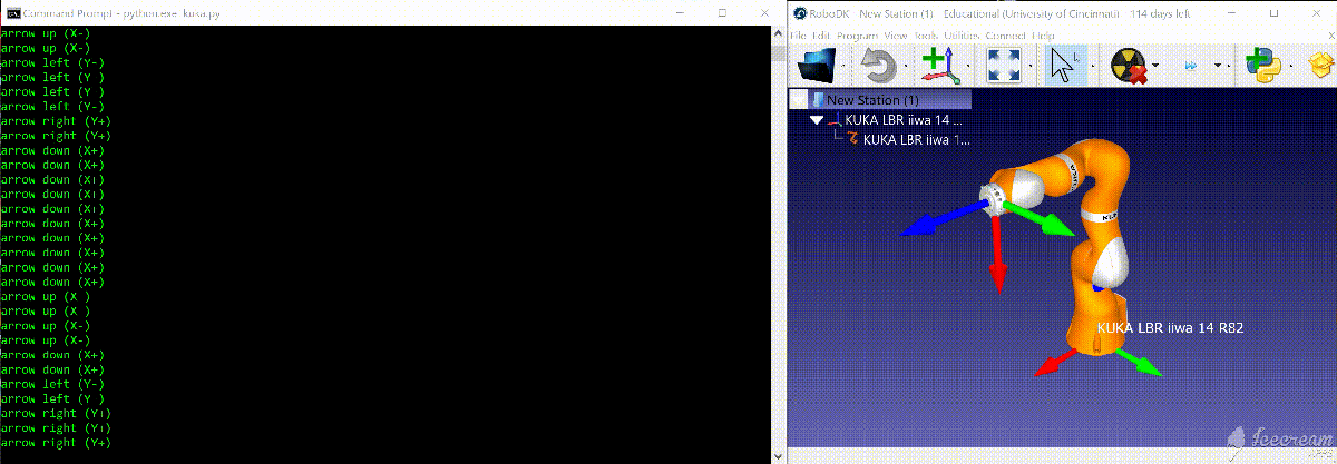

I think I have got the computer specific license. I requested the Robodk team to let me try the software for a couple of months as I am a college student. So, I was given a 4 months educational institution license, which I believe is computer specific. I re-installed the software ( even python) but I am still having the same issue(Seen in the below gif). @Jeremy and @Albert, any ideas??

Hi, I tried uninstalling and re-installing but the problem still persists. I tried the software on 3 laptops and 2 computer but it worked only on one computer. Rest of them had the same problem,I don't know why. I have a network license, so I guess I will transfer this to another computer. As I won't always have access to that computer,I would like to know the reason for this bug.
