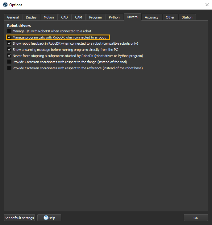

Again, there is nothing attached to your post. Anyway, can you make sure this option is activated? Jeremy

Hi All,
I have found the solution. In order to run a main program with program calls on the robot directly by RoboDK, you first have to right click each program called by the main program and select "Run on Robot" . Thereafter right click the main program and select first "Run on Robot" and thereafter "Run". Obviously you first have to connect to Robot before doing the above. Regards Curt
