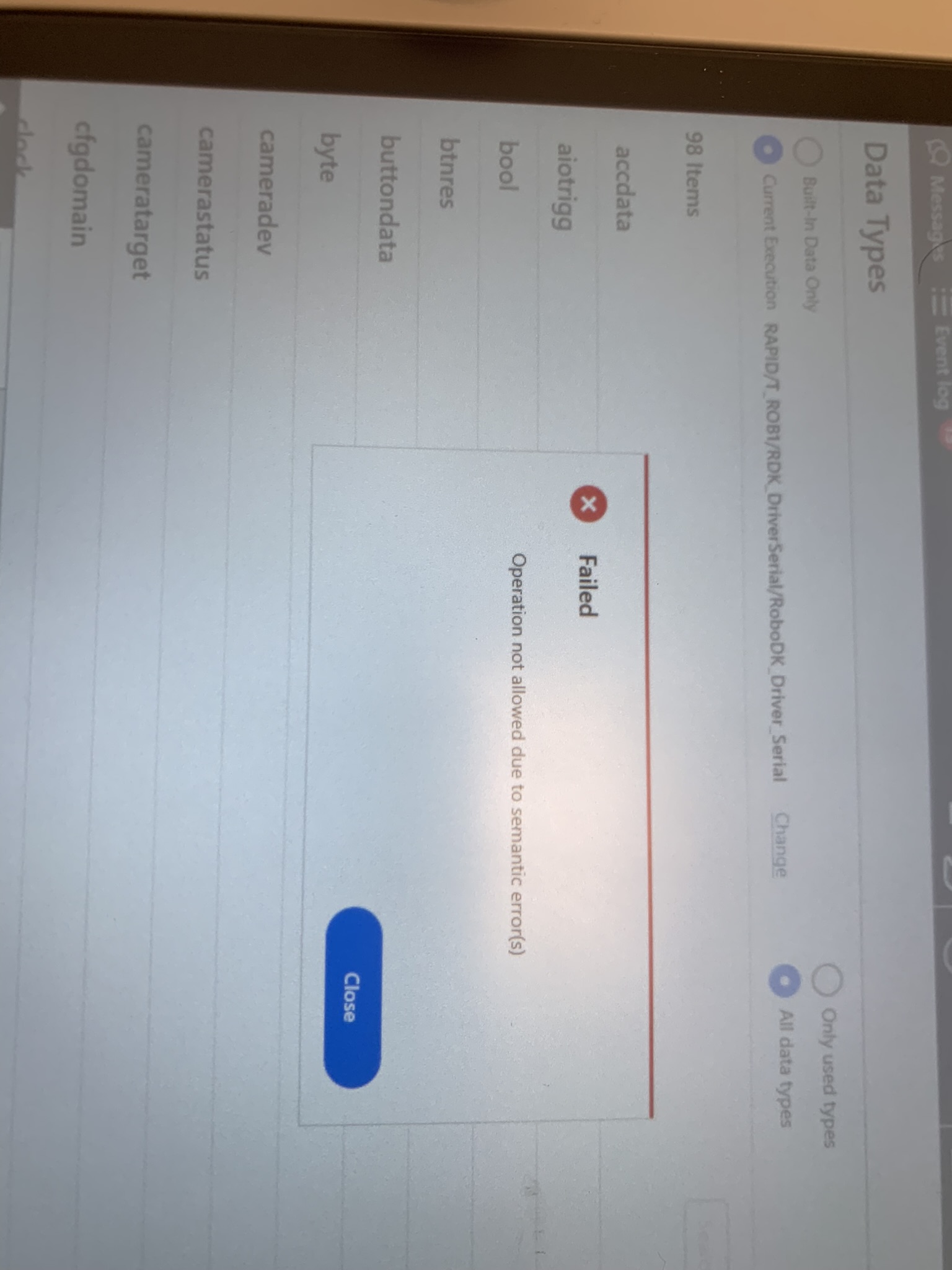

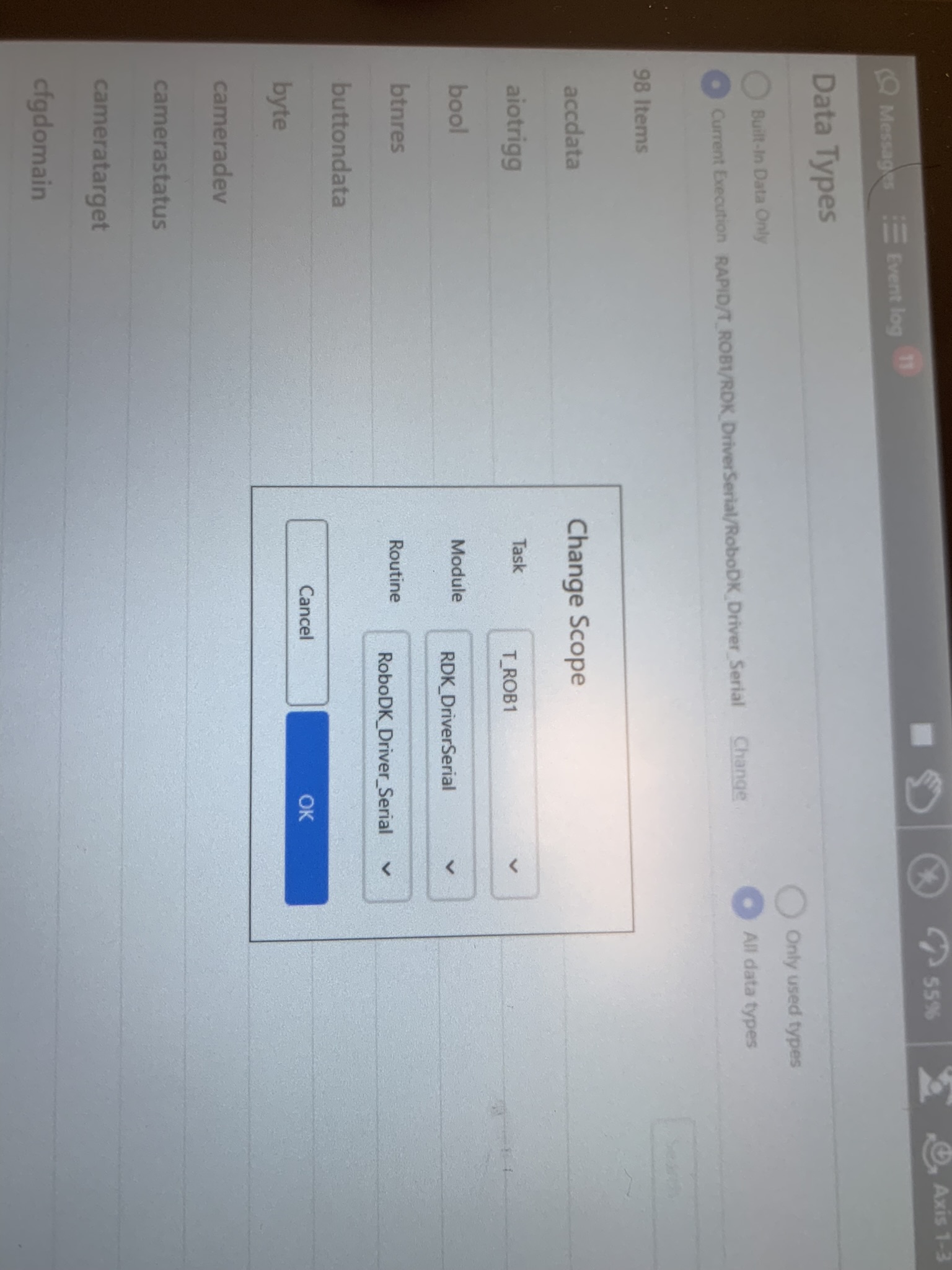

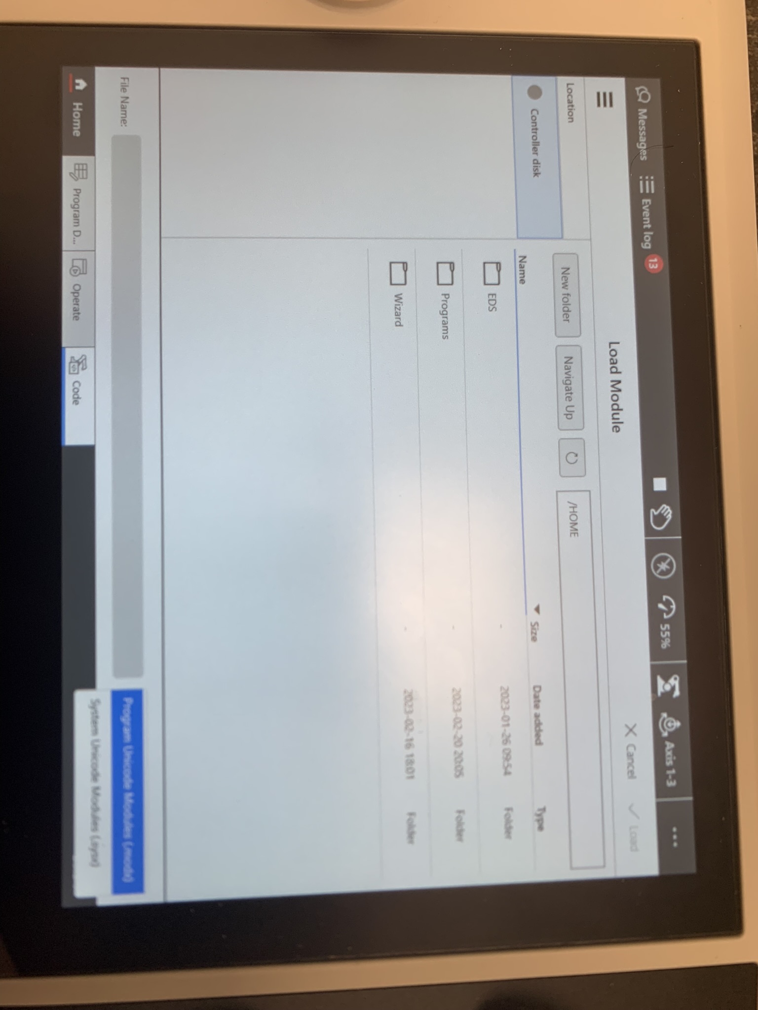

But when I transfer the the mod files through robot studio , and try to load the modules , the module selector only allows modx and other sysx  types.

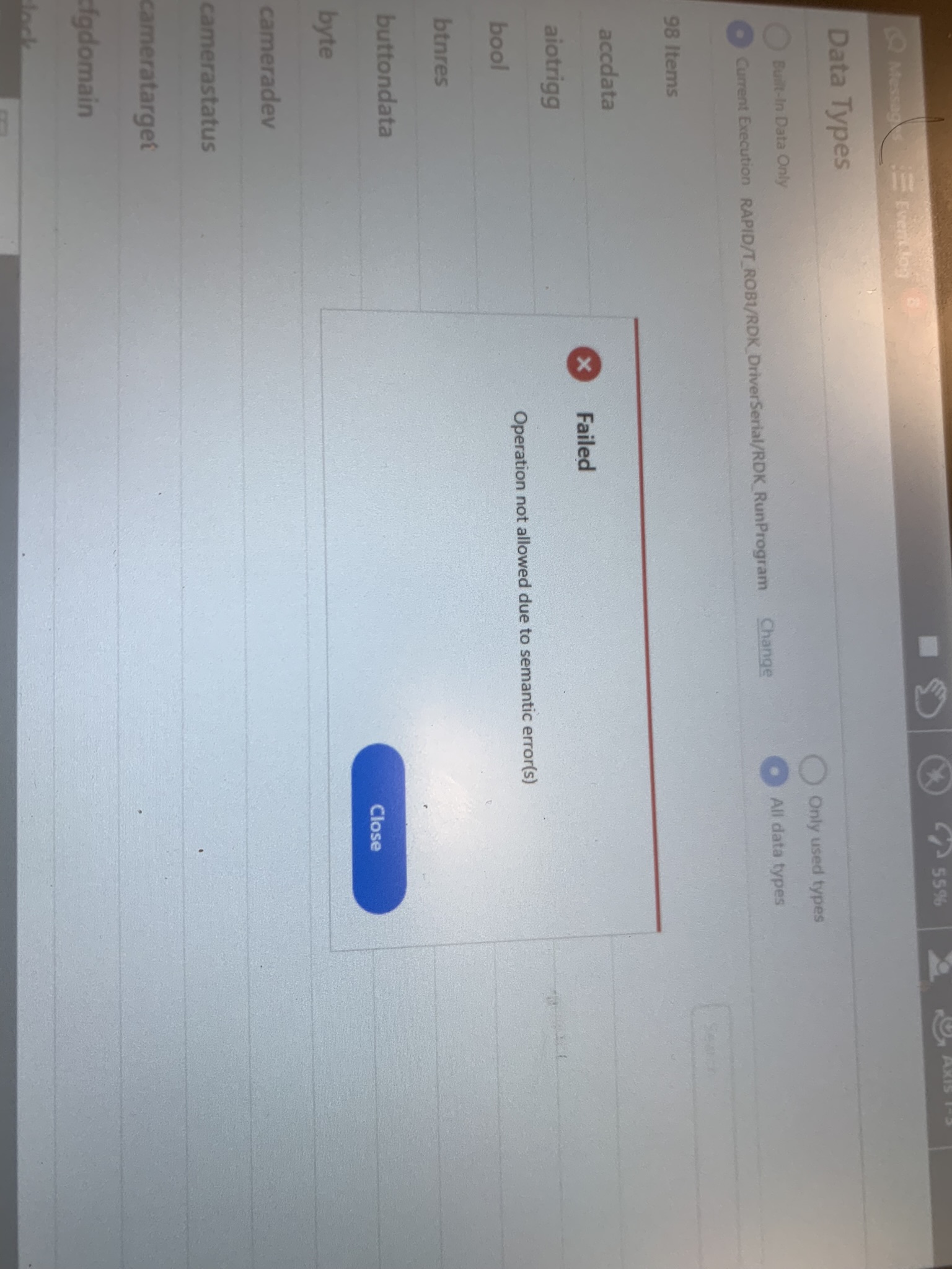

Even when I try to run the program from the data types , it gives me an error due to semantic errors?
Can you please advise?

Do you have more information about the semantic errors?
Did you try loading the socket version of the driver? I see you tried loading the serial one.
