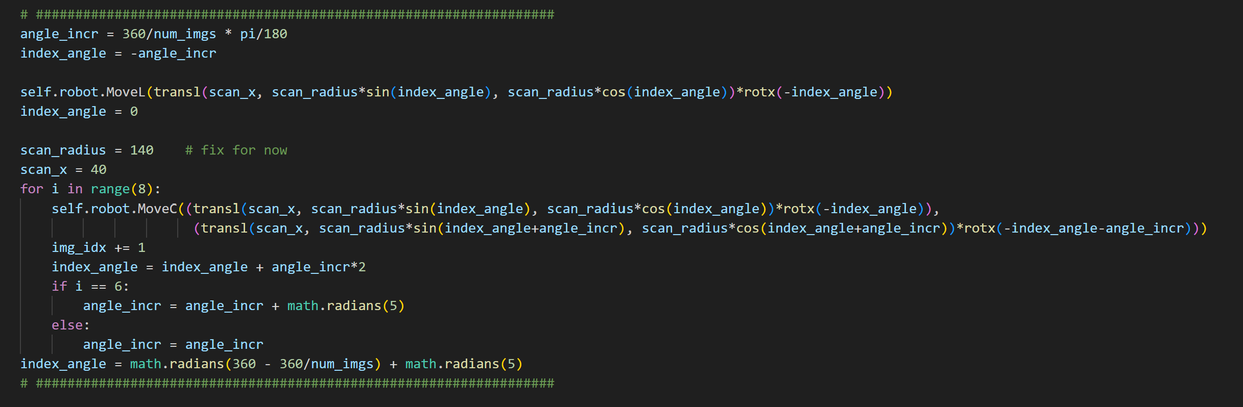

I am using Fanuc robot. I am using MoveC() function to follow a circle. It is a for loop that is ran 8 times, where we increment the targets until we have a full circle. Currently, after each MoveC(), the robot stops. However, the goal is to have a smooth continuous circular motion. I have tried adding the setRounding() function and played with parameters 5, 10, 50, 100, but the results are the same. The robot is still stopping, unlike in the  simulation where it does not stop. Am I missing anything?

Attached is a snippet of my code.

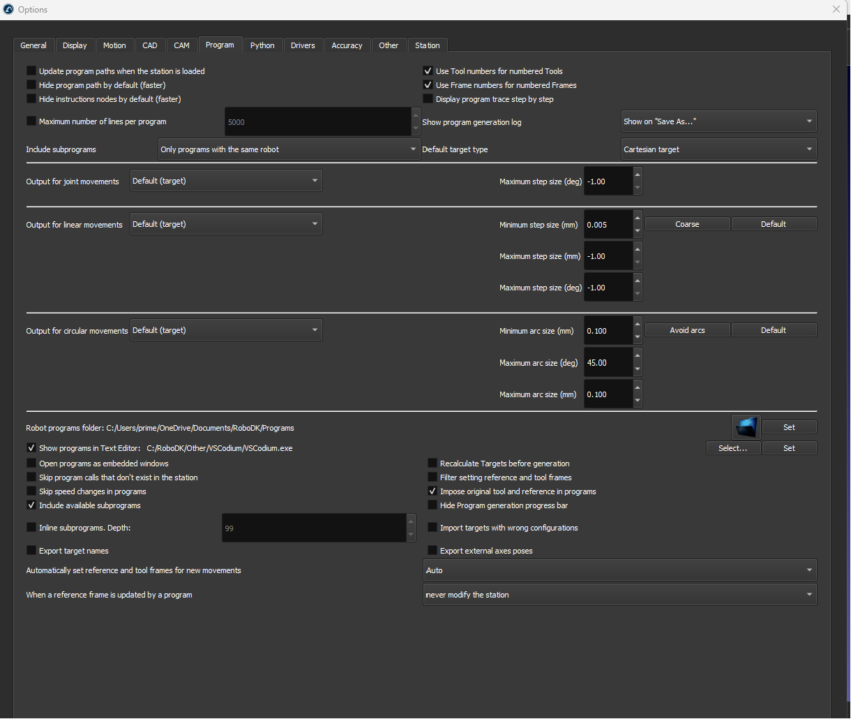

If you are having issues with circular movements (MoveC) on your controller I recommend you to convert the circular movements to linear movements (smaller MoveL movements).
You can follow these steps to do so:
  1. Select Tools-Options.
  2. Select the Program tab.
  3. Click on Avoid arcs.
  4. Specify the Maximum arc size (mm) which defines the size of the linear movements along the arc.
https://robodk.com/doc/en/Robot-Programs...ogArcToLin

I appreciate your response and suggestions! Attached is the changed parameters as you've mentioned. Using the same MoveC code, it is still stopping. Is this just a limitation due to the handshaking between RoboDK and the Fanuc Controller?
OK I assume you are using the driver and move the robot directly from RoboDK. In this case, the MoveC won't be split into smaller movements.
Instead, I recommend you to create a Program using the API and generate the LS file. You should be able to easily create a program by replacing your robot variable for the following:
