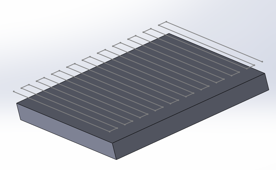

I want to scan a flat piece of 100x100 mm with 5 mm intervals. Should I do it by adding a target point to each point. Is there a short method for this process.
