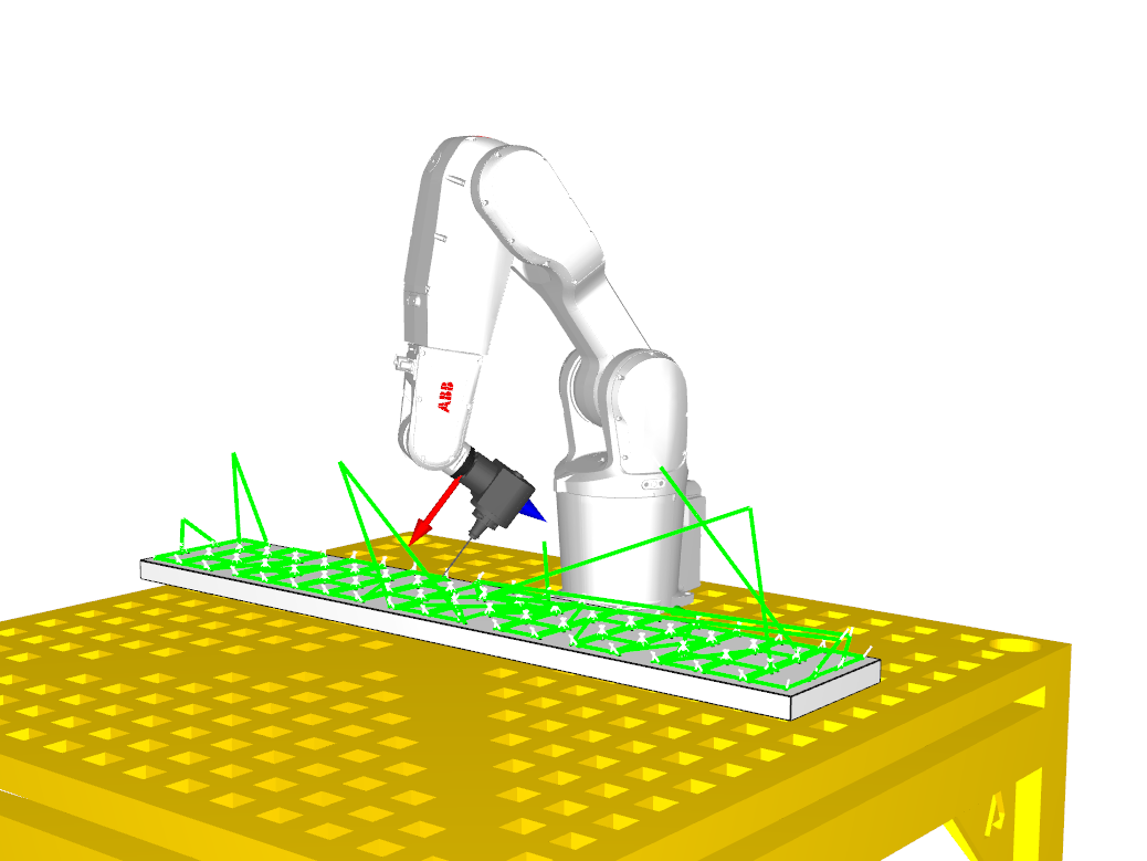

I'm working on setting up a drilling operation for an ABB 1200. The program is to drill a series of holes at four different angles. Depending on which holes are being drilled and their respective angles, the TCP rotation about the Z-axis needs to change to allow for clearance of the spindle above the stock and the workbench. Is it possible to allow the TCP to rotate freely about the Z-axis? Or can I assign different TCPs in the same program to accomplish this?

In tools -> Options -> CAM, there a check box called "Allow automatic collision avoidance".
Try checking this box and re-updating your "Point follow project".
(Note that the calculation time can take some time with this option)

Thanks! I checked that box and updated my toolpath but that didn't change anything. Can you clarify what you mean by "point follow project"? I am working with CAM that was imported directly from Fusion 360.
